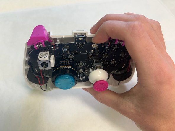

    • Orient the controller so the back side is facing you.
    • Use a Phillips #000 screwdriver to remove the seven 9 mm screws that secure the back shell.

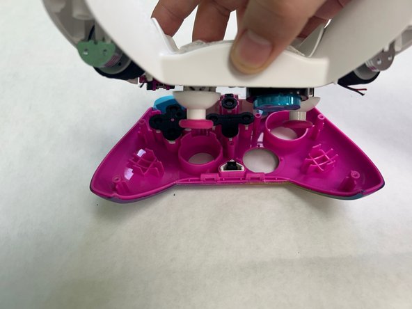

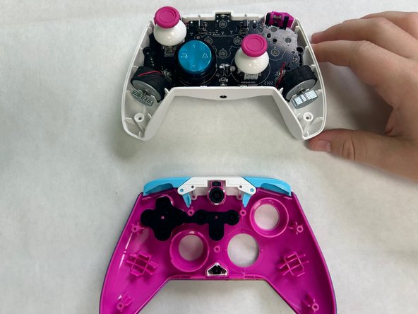

    • Pull apart the controller's front and back shells with moderate force.
    • Orient the controller so that the front shell is facing the floor to prevent the face buttons from falling out.

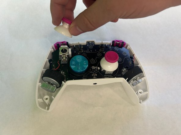

    • Twist the thumbstick to remove it from the motherboard.

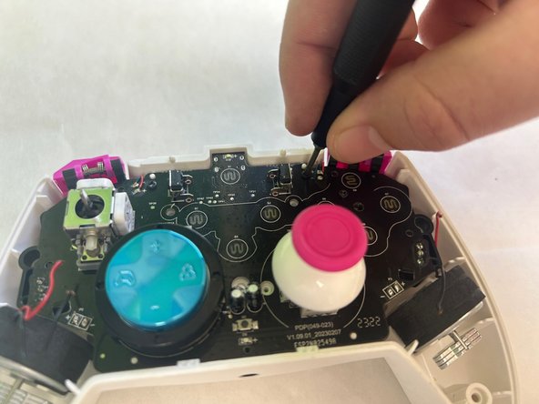

  4. PDP Rematch Advanced Trigger Springs Replacement: crwdns2935265:04crwdnd2935265:01crwdnd2935265:03crwdne2935265:0 PDP Rematch Advanced Trigger Springs Replacement: crwdns2935265:04crwdnd2935265:02crwdnd2935265:03crwdne2935265:0 PDP Rematch Advanced Trigger Springs Replacement: crwdns2935265:04crwdnd2935265:03crwdnd2935265:03crwdne2935265:0
    • Use a Phillips #000 screwdriver to remove the two 5 mm screws that secure the motherboard.
    • Remove the motherboard from the back shell using moderate force.
  5. PDP Rematch Advanced Trigger Springs Replacement: crwdns2935265:05crwdnd2935265:01crwdnd2935265:03crwdne2935265:0 PDP Rematch Advanced Trigger Springs Replacement: crwdns2935265:05crwdnd2935265:02crwdnd2935265:03crwdne2935265:0 PDP Rematch Advanced Trigger Springs Replacement: crwdns2935265:05crwdnd2935265:03crwdnd2935265:03crwdne2935265:0

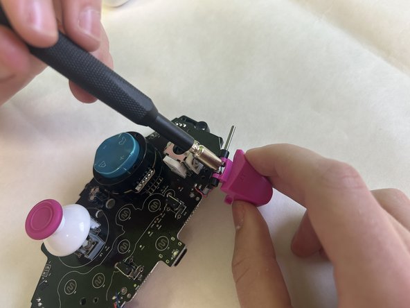

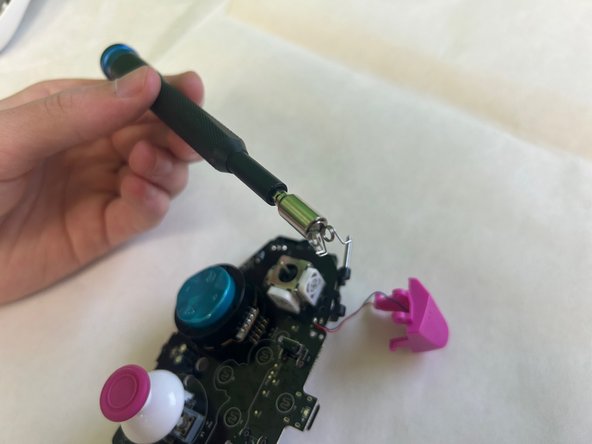

    • Punch out the metal pin holding in the trigger and the trigger spring. Repeat for both triggers.
    • Remove the trigger and the trigger springs.
    • Using a punch or a small tool allows pin removal to be easier.
