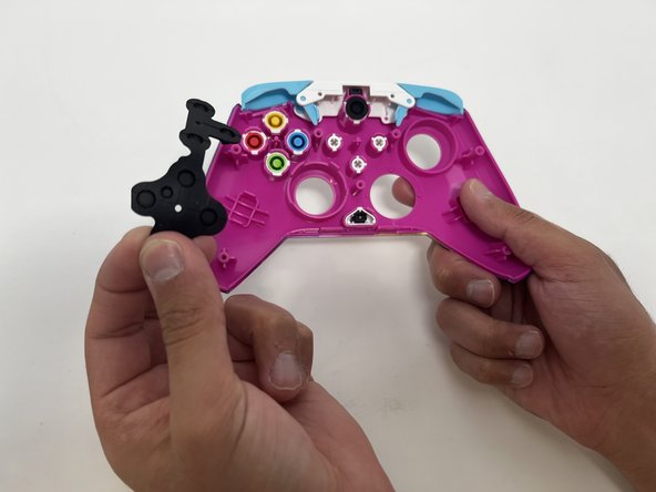

    • Peel the rubber piece off the back of the face buttons.

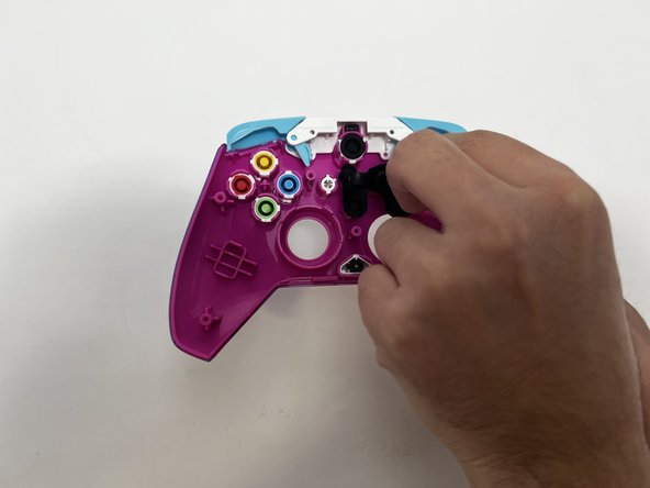

    • Push all the face buttons out from the front of the shell.

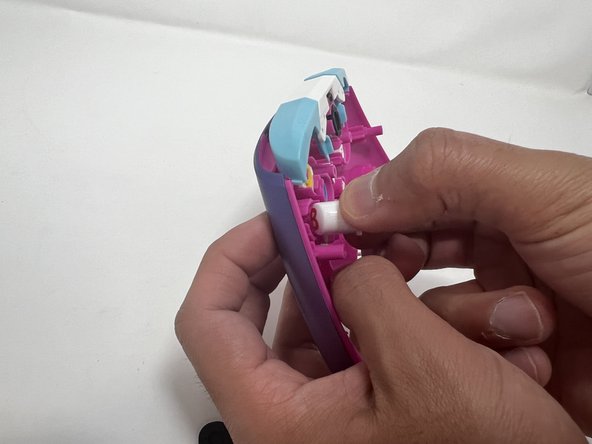

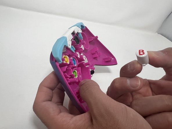

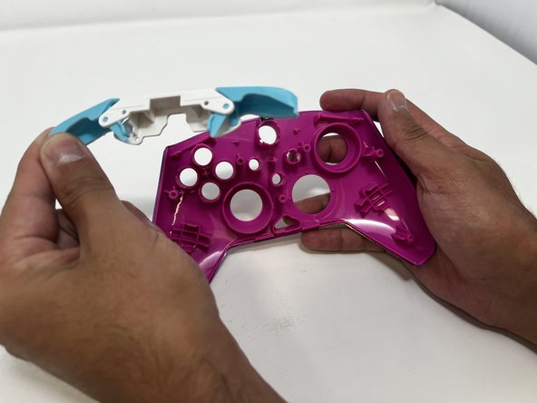

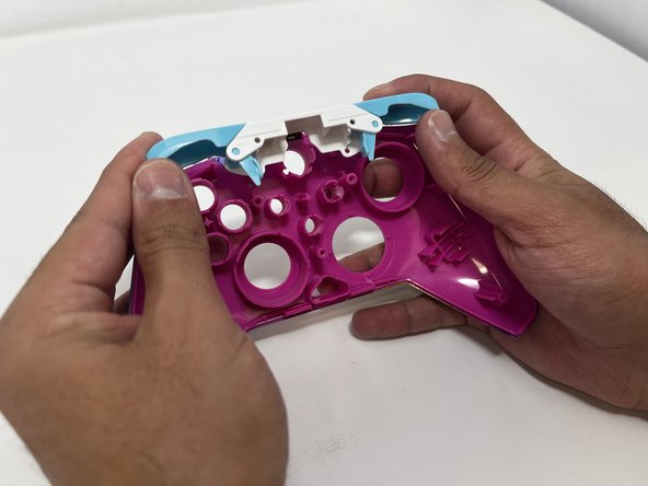

    • Put two fingers behind the bumpers and push upwards to remove them.
  6. PDP Rematch Advanced Shoulder Buttons Replacement, Shoulder Buttons: crwdns2935265:06crwdnd2935265:01crwdnd2935265:03crwdne2935265:0 PDP Rematch Advanced Shoulder Buttons Replacement, Shoulder Buttons: crwdns2935265:06crwdnd2935265:02crwdnd2935265:03crwdne2935265:0 PDP Rematch Advanced Shoulder Buttons Replacement, Shoulder Buttons: crwdns2935265:06crwdnd2935265:03crwdnd2935265:03crwdne2935265:0

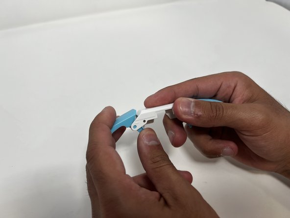

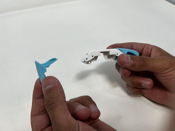

    • Push down on the trigger's long paddle.
    • Carefully twist the bumper out to remove it from the bumper frame.
