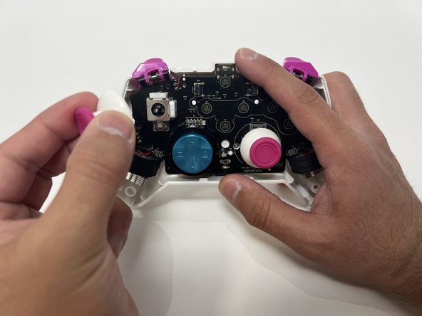

  3. PDP Rematch Advanced Joystick Cover Replacement: crwdns2935265:03crwdnd2935265:01crwdnd2935265:02crwdne2935265:0 PDP Rematch Advanced Joystick Cover Replacement: crwdns2935265:03crwdnd2935265:02crwdnd2935265:02crwdne2935265:0
    • Twist the thumbstick to remove it from the motherboard. Repeat this step if both thumbsticks need to be replaced.
