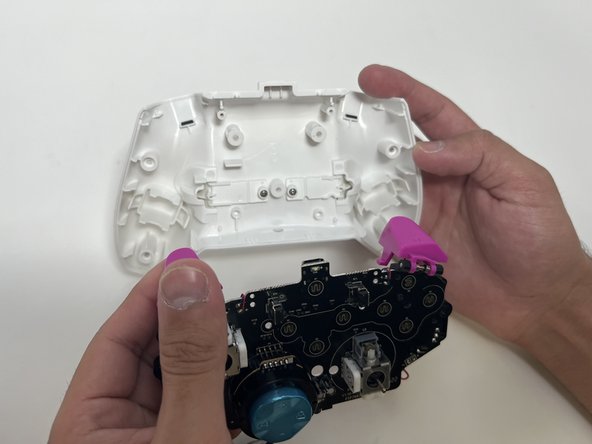

The back buttons on your PDP Rematch Advanced should be replaced if they are getting stuck and not being pressed down completely. If you need to replace the back button, take out the motherboard with this guide. The back buttons are attached to the back shell. The back buttons can be removed by taking out the components located behind the motherboard.
    1. PDP Rematch Advanced Back Buttons Replacement, Joystick Cover: crwdns2935265:01crwdnd2935265:01crwdnd2935265:03crwdne2935265:0 PDP Rematch Advanced Back Buttons Replacement, Joystick Cover: crwdns2935265:01crwdnd2935265:02crwdnd2935265:03crwdne2935265:0 PDP Rematch Advanced Back Buttons Replacement, Joystick Cover: crwdns2935265:01crwdnd2935265:03crwdnd2935265:03crwdne2935265:0

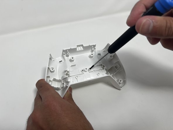

      • Orient the controller so the back side is facing you.
      • Use a Phillips #000 screwdriver to remove the seven 9 mm screws that secure the back shell.
    2. PDP Rematch Advanced Back Buttons Replacement: crwdns2935265:02crwdnd2935265:01crwdnd2935265:03crwdne2935265:0 PDP Rematch Advanced Back Buttons Replacement: crwdns2935265:02crwdnd2935265:02crwdnd2935265:03crwdne2935265:0 PDP Rematch Advanced Back Buttons Replacement: crwdns2935265:02crwdnd2935265:03crwdnd2935265:03crwdne2935265:0
      • Pull apart the controller's front and back shells with moderate force.
      • Orient the controller so that the front shell is facing the floor to prevent the face buttons from falling out.
    3. PDP Rematch Advanced Back Buttons Replacement: crwdns2935265:03crwdnd2935265:01crwdnd2935265:02crwdne2935265:0 PDP Rematch Advanced Back Buttons Replacement: crwdns2935265:03crwdnd2935265:02crwdnd2935265:02crwdne2935265:0
      • Twist the thumbstick to remove it from the motherboard. Repeat this step if both thumbsticks need to be replaced.
    1. PDP Rematch Advanced Back Buttons Replacement, Back Shell: crwdns2935265:04crwdnd2935265:01crwdnd2935265:02crwdne2935265:0 PDP Rematch Advanced Back Buttons Replacement, Back Shell: crwdns2935265:04crwdnd2935265:02crwdnd2935265:02crwdne2935265:0

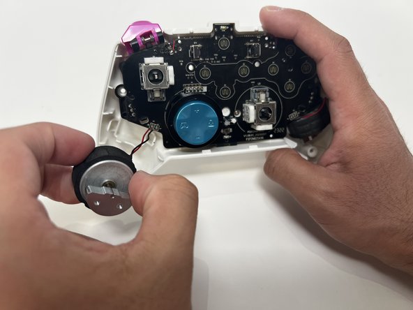

      • Grab the motor and pull away from the back shell. Repeat for both motors.
    2. PDP Rematch Advanced Back Buttons Replacement: crwdns2935265:05crwdnd2935265:01crwdnd2935265:02crwdne2935265:0 PDP Rematch Advanced Back Buttons Replacement: crwdns2935265:05crwdnd2935265:02crwdnd2935265:02crwdne2935265:0

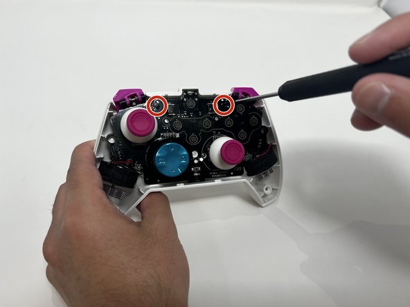

      • Use a Phillips #00 Screwdriver to remove the two 5mm screws from the motherboard.
    3. PDP Rematch Advanced Back Buttons Replacement: crwdns2935265:06crwdnd2935265:01crwdnd2935265:03crwdne2935265:0 PDP Rematch Advanced Back Buttons Replacement: crwdns2935265:06crwdnd2935265:02crwdnd2935265:03crwdne2935265:0 PDP Rematch Advanced Back Buttons Replacement: crwdns2935265:06crwdnd2935265:03crwdnd2935265:03crwdne2935265:0

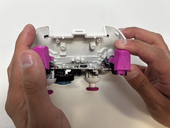

      • Remove the motherboard from the back shell using moderate force.

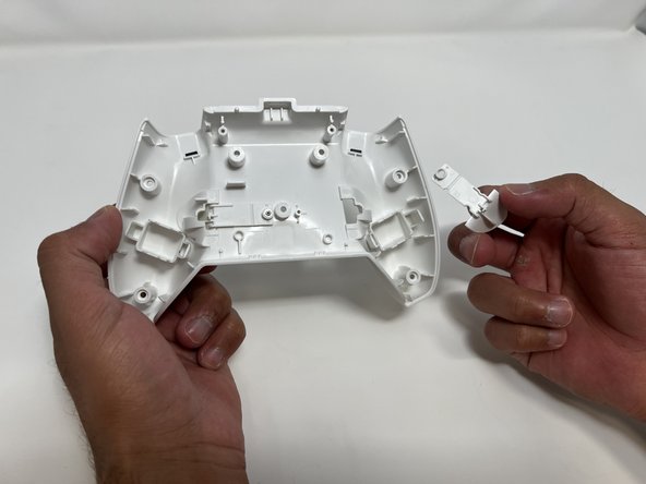

    1. PDP Rematch Advanced Back Buttons Replacement, Back Buttons: crwdns2935265:07crwdnd2935265:01crwdnd2935265:02crwdne2935265:0 PDP Rematch Advanced Back Buttons Replacement, Back Buttons: crwdns2935265:07crwdnd2935265:02crwdnd2935265:02crwdne2935265:0
      • Use a Phillips #00 to remove the two 5mm screws from the back buttons.

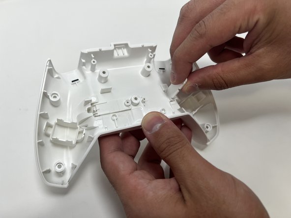

    2. PDP Rematch Advanced Back Buttons Replacement: crwdns2935265:08crwdnd2935265:01crwdnd2935265:03crwdne2935265:0 PDP Rematch Advanced Back Buttons Replacement: crwdns2935265:08crwdnd2935265:02crwdnd2935265:03crwdne2935265:0 PDP Rematch Advanced Back Buttons Replacement: crwdns2935265:08crwdnd2935265:03crwdnd2935265:03crwdne2935265:0
      • Lift the back button, and then pull it out through the back shell. Do this for both back buttons.
