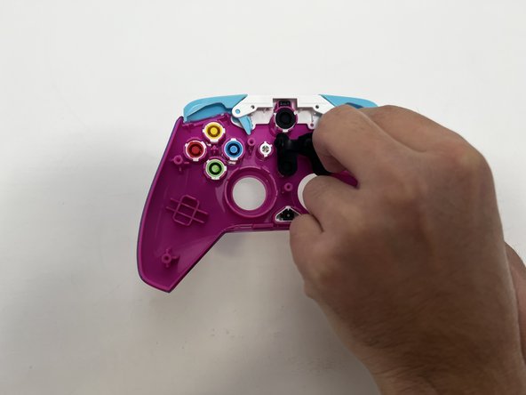

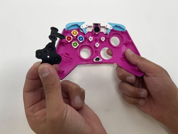

    • Peel the rubber gasket off the back of the action buttons.

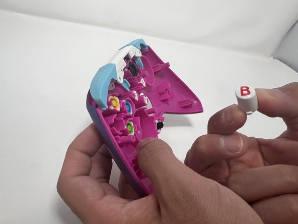

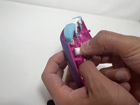

    • Push all the action buttons out from the front of the shell.
