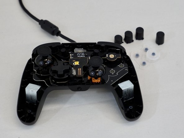

    2. PDP Rematch Action Buttons Replacement: crwdns2935265:02crwdnd2935265:01crwdnd2935265:02crwdne2935265:0 PDP Rematch Action Buttons Replacement: crwdns2935265:02crwdnd2935265:02crwdnd2935265:02crwdne2935265:0
      • Remove the 8 mm screws from the hard cover using a JIS #00 screwdriver.
      • Since the screws have been removed, avoid shaking or moving your controller too much to prevent other buttons from falling out.
    3. PDP Rematch Action Buttons Replacement: crwdns2935265:03crwdnd2935265:01crwdnd2935265:02crwdne2935265:0 PDP Rematch Action Buttons Replacement: crwdns2935265:03crwdnd2935265:02crwdnd2935265:02crwdne2935265:0
      • Gently lift off the hard cover with your hand; it should not need much force.

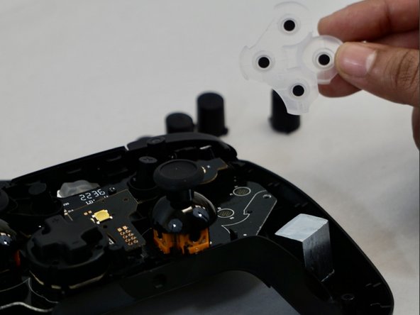

    1. PDP Rematch Action Buttons Replacement, Action Buttons: crwdns2935265:04crwdnd2935265:01crwdnd2935265:01crwdne2935265:0
      • Optional: Use a cotton pad or cotton swab with some alcohol to gently clean any debris.
      • These buttons are not connected to the device and will fall out, so be careful.
    2. PDP Rematch Action Buttons Replacement: crwdns2935265:05crwdnd2935265:01crwdnd2935265:03crwdne2935265:0 PDP Rematch Action Buttons Replacement: crwdns2935265:05crwdnd2935265:02crwdnd2935265:03crwdne2935265:0 PDP Rematch Action Buttons Replacement: crwdns2935265:05crwdnd2935265:03crwdnd2935265:03crwdne2935265:0
      • Carefully remove the buttons from the device and set them aside.
      • From here, you can do a deeper clean, or replace them.
      • The clear plate will not sit right or click into place if the buttons are not aligned straight.
