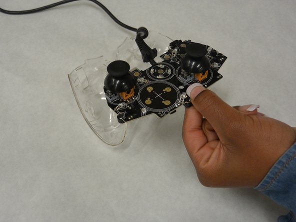

    1. PDP Afterglow Wired Xbox 360 Controller LEDs Replacement, LEDs: crwdns2935265:04crwdnd2935265:01crwdnd2935265:02crwdne2935265:0 PDP Afterglow Wired Xbox 360 Controller LEDs Replacement, LEDs: crwdns2935265:04crwdnd2935265:02crwdnd2935265:02crwdne2935265:0
      • Remove the logic board from the controller casing by lifting up and pulling out.
    2. PDP Afterglow Wired Xbox 360 Controller LEDs Replacement: crwdns2935265:05crwdnd2935265:01crwdnd2935265:01crwdne2935265:0
      • Locate the LED (s) that needs to be replaced.
      • Once the LED has been located, flip the logic board to the other side and locate the pins associated with the LED that needs to be replaced.
    3. PDP Afterglow Wired Xbox 360 Controller LEDs Replacement: crwdns2935265:06crwdnd2935265:01crwdnd2935265:01crwdne2935265:0
      • Desolder the LED from the logic board.
      • The soldering iron is very hot and can harm you or the device if used improperly.
