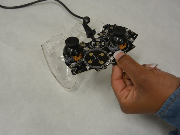

  4. PDP Afterglow Wired Xbox 360 Controller Cable Replacement, Cable: crwdns2935265:04crwdnd2935265:01crwdnd2935265:02crwdne2935265:0 PDP Afterglow Wired Xbox 360 Controller Cable Replacement, Cable: crwdns2935265:04crwdnd2935265:02crwdnd2935265:02crwdne2935265:0
    • Remove the logic board by lifting up on the logic board and pulling out.
  5. PDP Afterglow Wired Xbox 360 Controller Cable Replacement: crwdns2935265:05crwdnd2935265:01crwdnd2935265:01crwdne2935265:0
    • The cable connects to the logic board with a white connector. Above the right joystick, there are four solder pins labeled GND, VCC, DM, and DP.

  7. PDP Afterglow Wired Xbox 360 Controller Cable Replacement: crwdns2935265:07crwdnd2935265:01crwdnd2935265:01crwdne2935265:0
    • Using your new cable, solder the white connector to the logic board. Be sure to have the cables facing towards the inside of the logic board.
