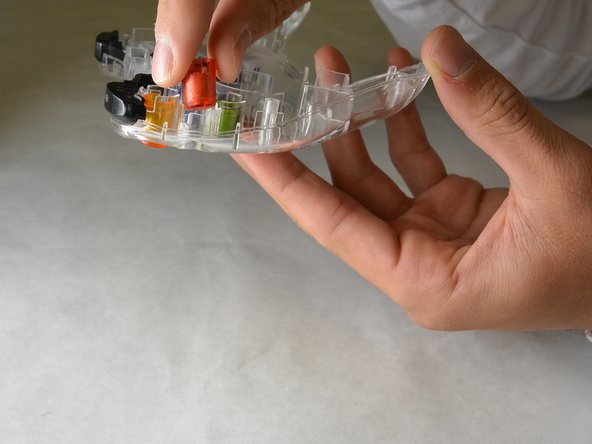

    1. PDP Afterglow Wired Xbox 360 Controller Button Replacement, Button: crwdns2935265:04crwdnd2935265:01crwdnd2935265:01crwdne2935265:0
      • Remove the rubber button covers from the A, B, X, and Y buttons.
    2. PDP Afterglow Wired Xbox 360 Controller Button Replacement: crwdns2935265:05crwdnd2935265:01crwdnd2935265:02crwdne2935265:0 PDP Afterglow Wired Xbox 360 Controller Button Replacement: crwdns2935265:05crwdnd2935265:02crwdnd2935265:02crwdne2935265:0
      • Push up on the buttons from the front and pull them out from the back.

What about removing the Dpad? i really need help.
Elijah Douglas - crwdns2934203:0crwdne2934203:0 crwdns2950251:0crwdne2950251:0
I’m sorry but, I have to say that the reassembly process is harder than simply ‘follow the instructions in reverse’; if you try and place the half with the buttons, the buttons fall out or end up misaligned ; and if you use the other half, the rubber covers and the tumblers will fall out.
Again, this guild comes off a little too simple, there’s more to it.
Christopher Mali-Martinez - crwdns2934203:0crwdne2934203:0 crwdns2950251:0crwdne2950251:0
the circuit board comes off the other half. You can stack them very easily. You're simply incorrect.
Tyler Anderson - crwdns2934203:0crwdne2934203:0 crwdns2950251:0crwdne2950251:0
No not really I agree with homeboy cause I just took mine apart to fix drifting and the one piece clip for RB and Lb doesn’t just fit in there right
