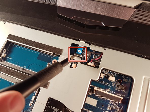

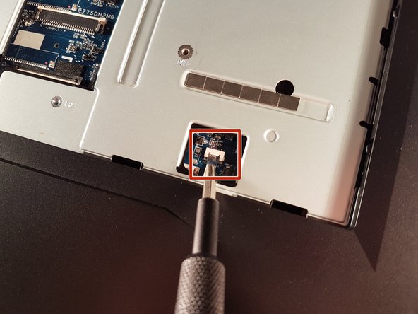

  31. P775DM3 Motherboard replacement: crwdns2935265:031crwdnd2935265:01crwdnd2935265:02crwdne2935265:0 P775DM3 Motherboard replacement: crwdns2935265:031crwdnd2935265:02crwdnd2935265:02crwdne2935265:0
    • Unscrew the twenty screws circled in red.
    • Unclip the edge of the case at the two places framed in green.
  32. P775DM3 Motherboard replacement: crwdns2935265:032crwdnd2935265:01crwdnd2935265:03crwdne2935265:0 P775DM3 Motherboard replacement: crwdns2935265:032crwdnd2935265:02crwdnd2935265:03crwdne2935265:0 P775DM3 Motherboard replacement: crwdns2935265:032crwdnd2935265:03crwdnd2935265:03crwdne2935265:0
    • Remove the top of the case.
