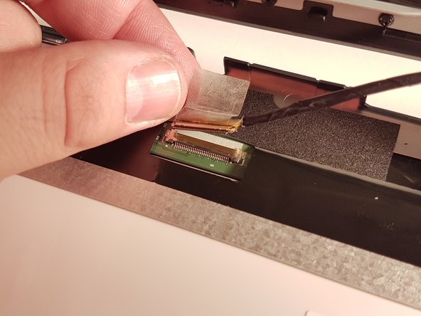

  5. P775DM3 LCD Screen Replacement: crwdns2935265:05crwdnd2935265:01crwdnd2935265:03crwdne2935265:0 P775DM3 LCD Screen Replacement: crwdns2935265:05crwdnd2935265:02crwdnd2935265:03crwdne2935265:0 P775DM3 LCD Screen Replacement: crwdns2935265:05crwdnd2935265:03crwdnd2935265:03crwdne2935265:0
    • Lift the tape that holds the connector (shown with red).
    • Disconnect the ribbon connector, shown with red.
    • Gently remove the screen.
To reassemble your device, follow the instructions in reverse order.
