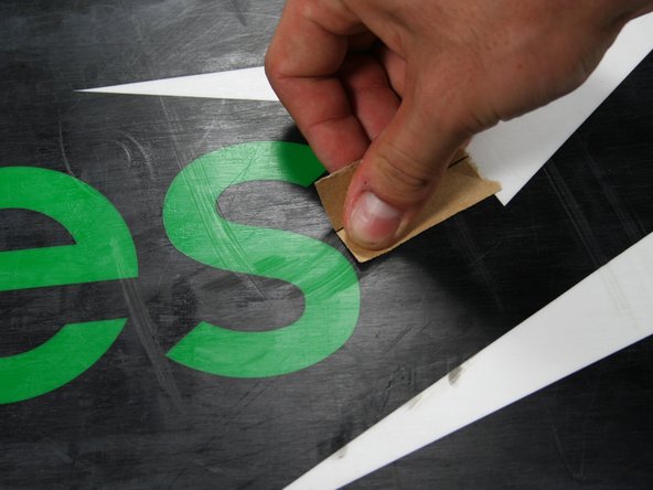

    • Assess the damage. If there are loose strands of material around the hole, slice them off carefully with a razor blade.
    • Remove any extra wax with a metal scraper.
    • Use 150 grit sandpaper to roughen up the inside of the gouge.
  6. P-Tex Repair: crwdns2935265:06crwdnd2935265:01crwdnd2935265:02crwdne2935265:0 P-Tex Repair: crwdns2935265:06crwdnd2935265:02crwdnd2935265:02crwdne2935265:0

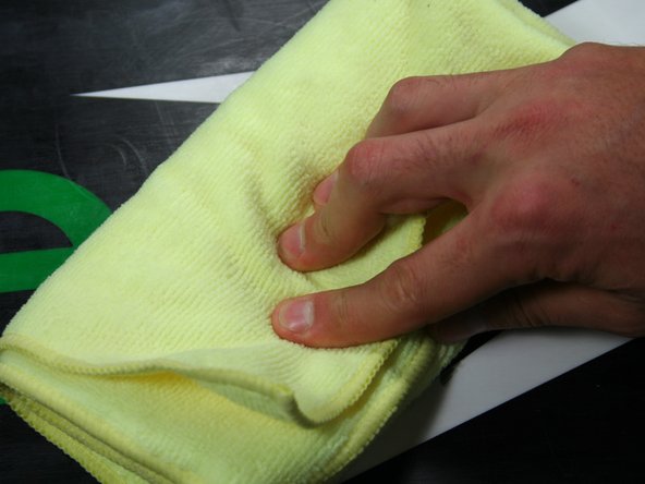

    • Clean the gouge with a few drops of citrus based cleaner such as Orange-Sol (rubbing alcohol will also work), and a small wire brush to get rid of any dirt or rocks. Let the cleaner dry completely—about 20 minutes to an hour.

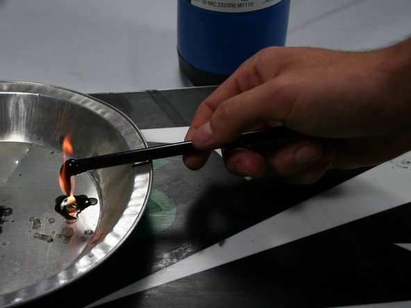

    • Using a propane torch or a butane lighter, heat up one tip of the P-Tex candle over a metal pan.
    • Use caution not to burn yourself - the flame is extremely hot.
    • Wait until the candle is flaming, which may take a couple of seconds.
    • Black carbon flakes will appear in the burning tip. DO NOT let them get into your base or the P-Tex will bond poorly.
    • Let the candle drip onto a metal pan and roll the molton tip around until the candle is carbon free.

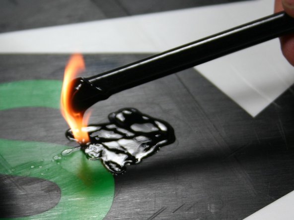

  8. P-Tex Repair: crwdns2935265:08crwdnd2935265:01crwdnd2935265:02crwdne2935265:0 P-Tex Repair: crwdns2935265:08crwdnd2935265:02crwdnd2935265:02crwdne2935265:0
    • It is important that the P-Tex is flowing and not dripping. Dripping will allow more impurities to enter the bonding surface and inhibit adhesion.
    • Move the molten P-Tex candle to the gouge. Hold it close to the surface and let it flow continuously into the gouge surface.
    • The P-Tex will shrink as it cools, so overfill the gouge.
    • Let the P-Tex cool for about 15 minutes.
