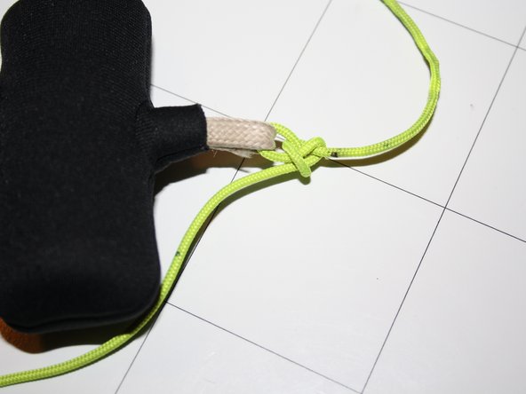

    • Open the brake handle knot on one of your brakes as shown in the pictures.
    • Take note how your brake handle knot is done. It may be a different knot than in my case which seems to be the way how Ozone and many other manufacturers do the knot.
    • Open the knot carefully. Try to not bend the line material too much!

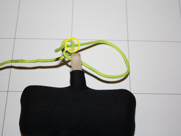

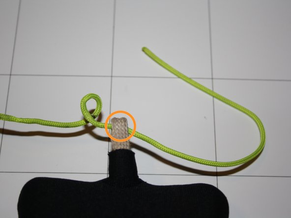

  4. Ozone Acro Brake Handles Installation, Attach the acro brake handle to the brake line - Part 1: crwdns2935265:04crwdnd2935265:01crwdnd2935265:03crwdne2935265:0 Ozone Acro Brake Handles Installation, Attach the acro brake handle to the brake line - Part 1: crwdns2935265:04crwdnd2935265:02crwdnd2935265:03crwdne2935265:0 Ozone Acro Brake Handles Installation, Attach the acro brake handle to the brake line - Part 1: crwdns2935265:04crwdnd2935265:03crwdnd2935265:03crwdne2935265:0
    • Make a little loop on the brake line (the open end beeing on the right hand side in the picture)
    • Put the brake line through the loop on the acro brake handle
    • put the open end of the line through the loop on the brake line (from behind)

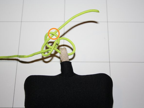

  5. Ozone Acro Brake Handles Installation, Attach the acro brake handle to the brake line - Part 2: crwdns2935265:05crwdnd2935265:01crwdnd2935265:03crwdne2935265:0 Ozone Acro Brake Handles Installation, Attach the acro brake handle to the brake line - Part 2: crwdns2935265:05crwdnd2935265:02crwdnd2935265:03crwdne2935265:0 Ozone Acro Brake Handles Installation, Attach the acro brake handle to the brake line - Part 2: crwdns2935265:05crwdnd2935265:03crwdnd2935265:03crwdne2935265:0
    • now route the open end of the brake line behind the brake line that goes up to the glider.
    • and back through the loop
    • Arrange the brake line knot that the mark on the brake line again is just over the brake line knot - and pull the knot tight
    • Be careful not to shorten the brake line!

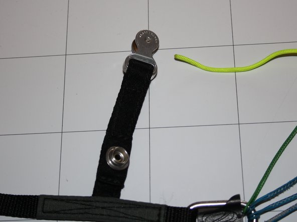

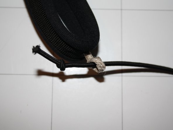

  7. Ozone Acro Brake Handles Installation, Brake handle bungee installation - Part 1: crwdns2935265:07crwdnd2935265:01crwdnd2935265:03crwdne2935265:0 Ozone Acro Brake Handles Installation, Brake handle bungee installation - Part 1: crwdns2935265:07crwdnd2935265:02crwdnd2935265:03crwdne2935265:0 Ozone Acro Brake Handles Installation, Brake handle bungee installation - Part 1: crwdns2935265:07crwdnd2935265:03crwdnd2935265:03crwdne2935265:0
    • Prepare bungees as shown in the picture with a loop on one side and a knot on the other side.
    • The loop should just be big enough to fit over your riser and not fall off.
    • Put the loop around the bottom of the riser as shown in the 2nd picture.
    • Do not pull the open end of the bungee through the loop at the bottom of the riser - the open end should come out to the 'outside' of the riser.
    • if it is the right riser, the bungee should come out on the right hand side of the riser if you are holding the riser as you would just put it to your carabiner

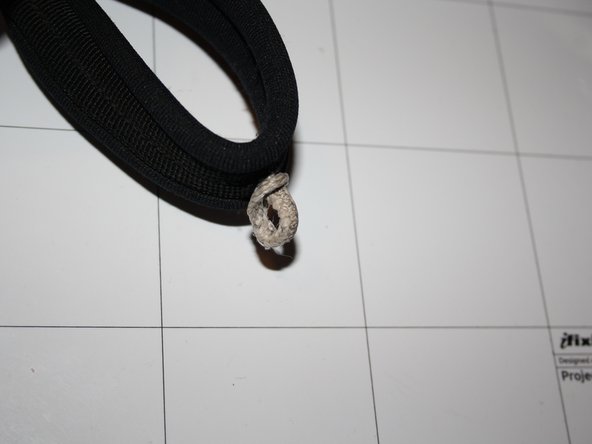

    • There is a loop on the bottom of the Ozone Acro Brake Handle. Prepare the loop as shown in the first and second picture
    • Put the bungee through the prepared loop
