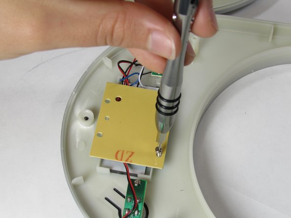

  10. Ozeri Pronto ZK14-S Wire Replacement, Wire: crwdns2935265:010crwdnd2935265:01crwdnd2935265:02crwdne2935265:0 Ozeri Pronto ZK14-S Wire Replacement, Wire: crwdns2935265:010crwdnd2935265:02crwdnd2935265:02crwdne2935265:0
    $5.49
    • Using the 2.0 Flathead screwdriver, remove the three 7.20 mm screws on the back of the center LCD motherboard.
  11. Ozeri Pronto ZK14-S Wire Replacement: crwdns2935265:011crwdnd2935265:01crwdnd2935265:01crwdne2935265:0
    • Stand the center motherboard up.
    • Be careful when standing up the LCD motherboard to avoid damaging the wires it is connected to.
