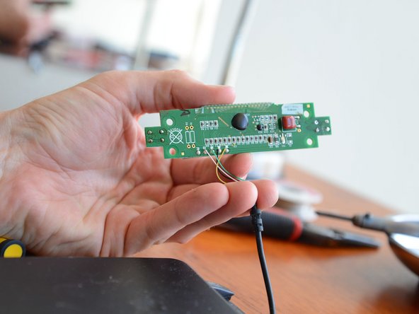

  3. Oxo 5lb Digital Kitchen Scale Faulty Button Replacement, Remove board from housing: crwdns2935265:03crwdnd2935265:01crwdnd2935265:02crwdne2935265:0 Oxo 5lb Digital Kitchen Scale Faulty Button Replacement, Remove board from housing: crwdns2935265:03crwdnd2935265:02crwdnd2935265:02crwdne2935265:0
    • Just undo the two screws and you're in.
    • Careful! Those 5 wispy little wires break pretty easily. I ended up having to resolder ALL of them, which was annoying. I'm almost tempted to recommend just breaking them off at the beginning and then resoldering them at the end just so you're sure they're attached well.

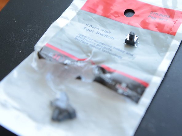

  4. Oxo 5lb Digital Kitchen Scale Faulty Button Replacement, Desolder the old switch and solder on the new switch: crwdns2935265:04crwdnd2935265:01crwdnd2935265:02crwdne2935265:0 Oxo 5lb Digital Kitchen Scale Faulty Button Replacement, Desolder the old switch and solder on the new switch: crwdns2935265:04crwdnd2935265:02crwdnd2935265:02crwdne2935265:0
    • I bought a pack of four 9.5mm tact switches at radio shack (which I had no idea still existed or sold electronic parts).
    • Important! Make sure if you don't buy the right size switch that you cut your switch down to the right size. I didn't, and when I glued the facepiece back on at the end, it held down the power switch and I had to take it off and sand the switch down.
    • Also, make sure you put a tiny bit of solder on all of the faces (8 total faces for four connections) before you try to solder them together. It'll be a lot easier to bond them. Afterward.
    • As I said before, these all broke off when I was doing this, so I had to resolder them.
    • Either way, make sure they're still well-connected.
    • Just follow the steps in reverse.
All in all a pretty easy repair, but watch out for those little scale wires, and make sure the new switch is reasonably flat against the board.

Thanks for the tutorial! My scale's circuit board was slightly different, the tact switches were mounted on the surface rather than through the hole, wasn't a problem though. I opted for slightly smaller switches at a length of 8.5mm based on another source online, still too big, sanded it down to match the existing ones. Overall a success!
