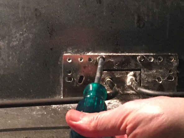

    • Open the oven door and unscrew the 5 mm Robertson head screws that keep the element in place.
    • In most cases, there will be two or three screws to remove.
    • Make sure you check the screws thoroughly in case there are more.

    • Using your voltmeter, place it on the two wires to make sure there is no electrical current.
    • Gently pull out the element two or three inches to expose the connecting wires.
