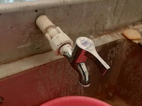

    • Check the location of the water leakage, and turn off the water to that area.
    • Drain the water in the pipeline after it is determined, so as to avoid a large amount of water flowing out during the repair process.
  2. Outdoor Faucet Head Replacement: crwdns2935265:02crwdnd2935265:01crwdnd2935265:01crwdne2935265:0
    • Use a wrench to remove the leaking faucet by turning it counter-clockwise.
    • Be careful not to damage the water pipe.

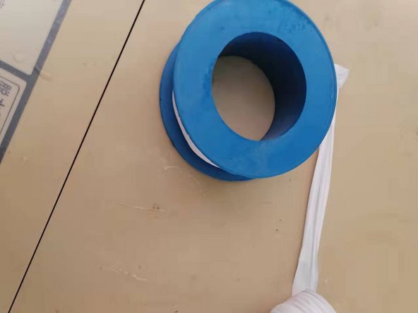

  3. Outdoor Faucet Head Replacement: crwdns2935265:03crwdnd2935265:01crwdnd2935265:02crwdne2935265:0 Outdoor Faucet Head Replacement: crwdns2935265:03crwdnd2935265:02crwdnd2935265:02crwdne2935265:0
    • Use PFTE tape to wrap the faucet mouth.
    • The purpose of this step is to prevent the faucet from still leaking after installation.
