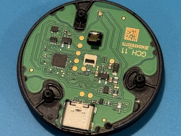

  2. Oura Ring 3 - Charger Repair, Removing the PCB: crwdns2935265:02crwdnd2935265:01crwdnd2935265:03crwdne2935265:0 Oura Ring 3 - Charger Repair, Removing the PCB: crwdns2935265:02crwdnd2935265:02crwdnd2935265:03crwdne2935265:0 Oura Ring 3 - Charger Repair, Removing the PCB: crwdns2935265:02crwdnd2935265:03crwdnd2935265:03crwdne2935265:0
    • With the screws removed, the bottom cover of the case can be easily removed, there are no clips.
    • In order to remove the PCB, make sure to unclip the ribbon cable that goes to the wireless coil.
    • You can now separate all 3 parts, so you can work solely on the PCB.

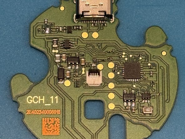

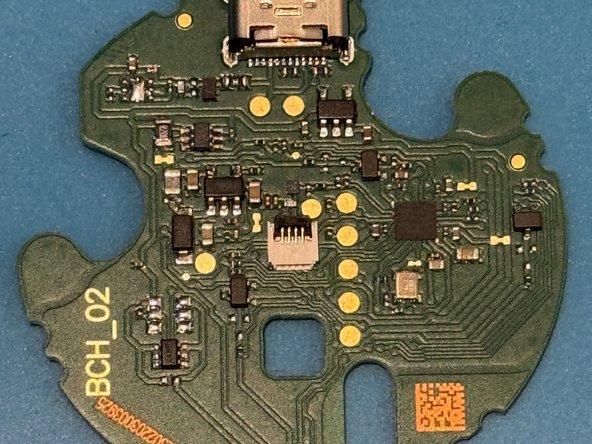

  3. Oura Ring 3 - Charger Repair, PCB Model Differences: crwdns2935265:03crwdnd2935265:01crwdnd2935265:03crwdne2935265:0 Oura Ring 3 - Charger Repair, PCB Model Differences: crwdns2935265:03crwdnd2935265:02crwdnd2935265:03crwdne2935265:0 Oura Ring 3 - Charger Repair, PCB Model Differences: crwdns2935265:03crwdnd2935265:03crwdnd2935265:03crwdne2935265:0
    • Do note that different models of chargers have different layouts. I had 3 chargers and all 3 were different models, with slight layout changes, but the actual parts and inner workings are the same.

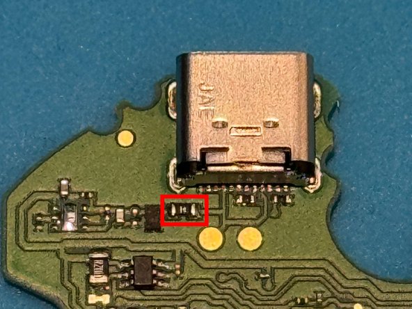

  4. Oura Ring 3 - Charger Repair, Fuse Location: crwdns2935265:04crwdnd2935265:01crwdnd2935265:03crwdne2935265:0 Oura Ring 3 - Charger Repair, Fuse Location: crwdns2935265:04crwdnd2935265:02crwdnd2935265:03crwdne2935265:0 Oura Ring 3 - Charger Repair, Fuse Location: crwdns2935265:04crwdnd2935265:03crwdnd2935265:03crwdne2935265:0
    • I recommend putting the PCB on a surface that's antistatic. Or use some clips.
    • In the 3rd image I have added a red rectangle around the fuse. It is right below the USB C port, to the left, on all models.
    • Use a multimeter to check for continuity. If the multimeter in diode mode makes noise when touching the 2 ends of the fuse, then the fuse is fine. Othewise, it is burnt and it needs fixing.
    • The fuse usually burns out due to weird behaviours with chargers that also do 6V for output. Some chargers have 5V, 6V, 9V and 12V outputs. It will not fail immediately, but overtime.

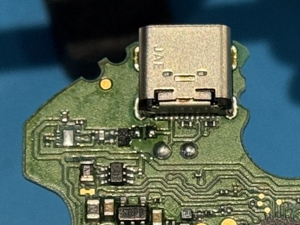

  5. Oura Ring 3 - Charger Repair, Removing the Fuse: crwdns2935265:05crwdnd2935265:01crwdnd2935265:02crwdne2935265:0 Oura Ring 3 - Charger Repair, Removing the Fuse: crwdns2935265:05crwdnd2935265:02crwdnd2935265:02crwdne2935265:0
    • Use a soldering station and some tweezers to remove the fuse. I recommend using some flux too if available, to simplify the removal. A hot air station will make everything even simpler.

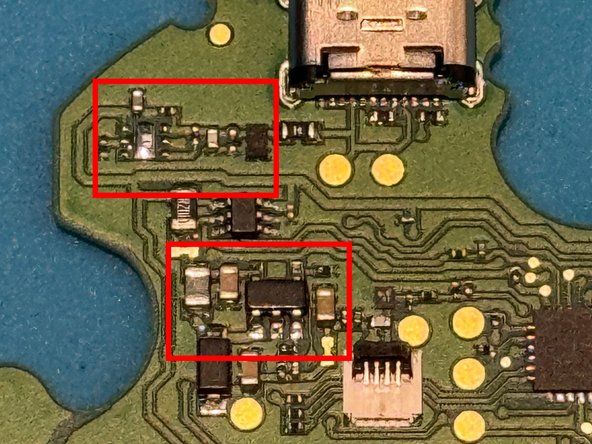

  6. Oura Ring 3 - Charger Repair, Adding a new Fuse and Checking for Short Circuits: crwdns2935265:06crwdnd2935265:01crwdnd2935265:02crwdne2935265:0 Oura Ring 3 - Charger Repair, Adding a new Fuse and Checking for Short Circuits: crwdns2935265:06crwdnd2935265:02crwdnd2935265:02crwdne2935265:0
    • Take the new 0402 fuse with a pair of tweezers and solder it back in a similar manner to the removal of the old fuse.
    • If you do not have or want to use a fuse you can simply bridge the 2 contact points and it will work the same without issues. But it is better to be on the safer side by replacing it.
    • At this point you should use a multimeter on any of the capacitors present to check for a short/continuity. If you do not hear anything, then you can plug the charger in, and the white light should reappear, with the charger working well.
    • If you have plugged the charger in without checking for continuity, you will get a yellow/red/orange led, with the charging chip heating up, which means that there is a short on one of the capacitors. That's why I recommend first to check the continuity.

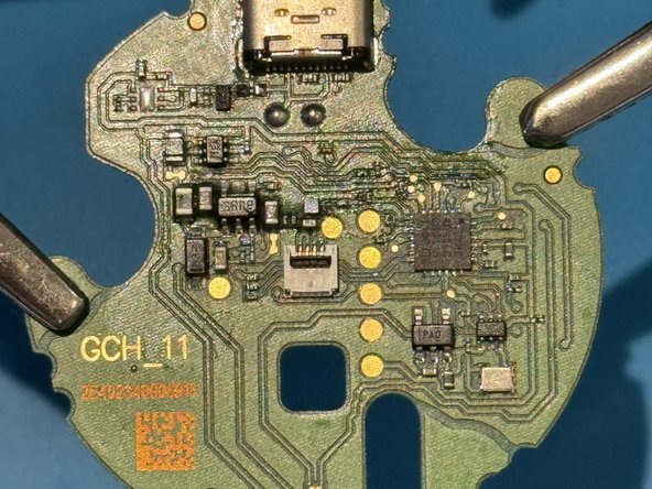

    • The second image has 2 red rectangles, any one of those capaciors could be burnt out. So what you have to do is remove them 1 by 1, until the short disappears, always checking with the multimeter. In my case, 1 charger was the fuse, one was that with the decoupling ceramic capacitor near the fuse (the black one). A 0.1uF 0603 SMD will do just fine.
  7. Oura Ring 3 - Charger Repair, Power Test: crwdns2935265:07crwdnd2935265:01crwdnd2935265:01crwdne2935265:0
    • You can now try the charger and it should work just fine.
    • This is a common issue on this charger so unless you use a 5V charger, you may run into this issue multiple times on all models.
    • Do note that the white light will turn off after a few seconds unless a ring is placed on top of the wireless coil and therefore, the charger is charging the ring (the white light goes to flashing/breathing). So do not worry if the light turns off while you are testing it after the repair, it is the intended behaviour.
