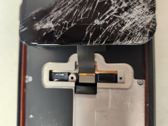

    5. Oukitel WP5 Pro Screen Replacement, Gently Lift the Screen Up: crwdns2935265:05crwdnd2935265:01crwdnd2935265:02crwdne2935265:0 Oukitel WP5 Pro Screen Replacement, Gently Lift the Screen Up: crwdns2935265:05crwdnd2935265:02crwdnd2935265:02crwdne2935265:0
      • When the screen comes loose, gently lift it up.
      • Fold it over onto itself to access the connection point.
      • If the screen is not loose enough to lift yet, work your plastic card back over the top and to the other side again as necessary. Remember to keep the plastic card minimally inserted and avoid the bottom of the screen.
    6. Oukitel WP5 Pro Screen Replacement: crwdns2935265:06crwdnd2935265:01crwdnd2935265:03crwdne2935265:0 Oukitel WP5 Pro Screen Replacement: crwdns2935265:06crwdnd2935265:02crwdnd2935265:03crwdne2935265:0 Oukitel WP5 Pro Screen Replacement: crwdns2935265:06crwdnd2935265:03crwdnd2935265:03crwdne2935265:0
      • Using your PH0 Screwdriver, remove the long screw from the bracket securing the LCD cable in place.
      • Using your PH0 Screwriver, remove the short screw from the bracket securing the LCD cable in place.
      • It is important that these screws be kept separate, as inserting the long screw into the shorter hole could cause internal damages.
      • It has been reported that some builds of this same phone model have an additional metal clip over the bracket secured down by glue. That will also need to be removed if you find this on yours.
    7. Oukitel WP5 Pro Screen Replacement, Remove the Securing Bracket: crwdns2935265:07crwdnd2935265:01crwdnd2935265:02crwdne2935265:0 Oukitel WP5 Pro Screen Replacement, Remove the Securing Bracket: crwdns2935265:07crwdnd2935265:02crwdnd2935265:02crwdne2935265:0
      • Using your tweezers, gently remove the bracket securing the LCD ribbon cable in place.
