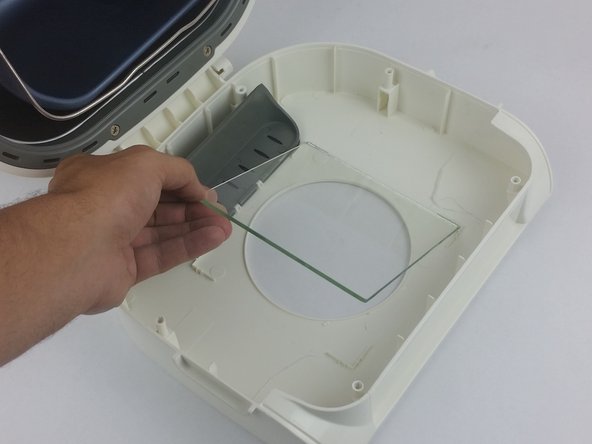

Oster Expressbake CKSTBRTW20 Top Viewing Glass Replacement
  1. Oster Expressbake CKSTBRTW20 Top Viewing Glass Replacement, Top Viewing Glass: crwdns2935265:01crwdnd2935265:01crwdnd2935265:02crwdne2935265:0 Oster Expressbake CKSTBRTW20 Top Viewing Glass Replacement, Top Viewing Glass: crwdns2935265:01crwdnd2935265:02crwdnd2935265:02crwdne2935265:0
    • Remove the six 55.4mm Phillips #1 screws from the top panel.
  2. Oster Expressbake CKSTBRTW20 Top Viewing Glass Replacement: crwdns2935265:02crwdnd2935265:01crwdnd2935265:01crwdne2935265:0
    • Lift the inner lining away from the device.
  3. Oster Expressbake CKSTBRTW20 Top Viewing Glass Replacement: crwdns2935265:03crwdnd2935265:01crwdnd2935265:02crwdne2935265:0 Oster Expressbake CKSTBRTW20 Top Viewing Glass Replacement: crwdns2935265:03crwdnd2935265:02crwdnd2935265:02crwdne2935265:0
    • Remove the viewing glass and replace.
