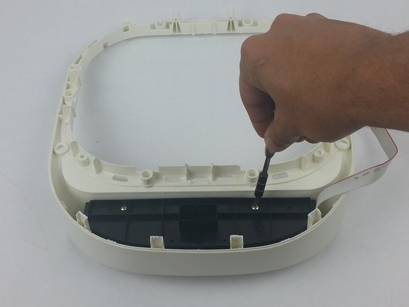

  4. Oster Expressbake CKSTBRTW20 Top Panel Buttons Replacement: crwdns2935265:04crwdnd2935265:01crwdnd2935265:02crwdne2935265:0 Oster Expressbake CKSTBRTW20 Top Panel Buttons Replacement: crwdns2935265:04crwdnd2935265:02crwdnd2935265:02crwdne2935265:0
    • Pop off the top case using a spudger.
    • Keep the spudger away from the control panel.
    • Be aware of wires connecting the microcontroller to the panel when removing the top lining.

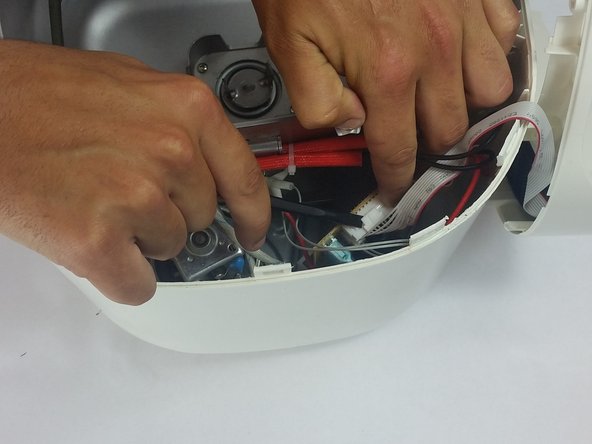

  5. Oster Expressbake CKSTBRTW20 Top Panel Buttons Replacement, Top Panel Buttons: crwdns2935265:05crwdnd2935265:01crwdnd2935265:03crwdne2935265:0 Oster Expressbake CKSTBRTW20 Top Panel Buttons Replacement, Top Panel Buttons: crwdns2935265:05crwdnd2935265:02crwdnd2935265:03crwdne2935265:0 Oster Expressbake CKSTBRTW20 Top Panel Buttons Replacement, Top Panel Buttons: crwdns2935265:05crwdnd2935265:03crwdnd2935265:03crwdne2935265:0

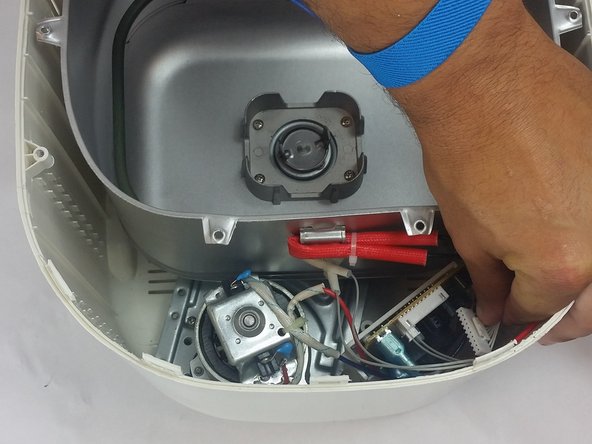

    • Disconnect microcontroller and top lining.
    • Ground yourself prior to disconnecting in order to avoid harming the inner electronics.

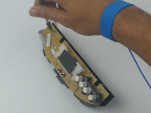

  6. Oster Expressbake CKSTBRTW20 Top Panel Buttons Replacement: crwdns2935265:06crwdnd2935265:01crwdnd2935265:02crwdne2935265:0 Oster Expressbake CKSTBRTW20 Top Panel Buttons Replacement: crwdns2935265:06crwdnd2935265:02crwdnd2935265:02crwdne2935265:0
    • Remove the two 11mm Phillips #1 screws from the top cover.
  7. Oster Expressbake CKSTBRTW20 Top Panel Buttons Replacement: crwdns2935265:07crwdnd2935265:01crwdnd2935265:01crwdne2935265:0
    • Use spudger to pop the control panel out.
  8. Oster Expressbake CKSTBRTW20 Top Panel Buttons Replacement: crwdns2935265:08crwdnd2935265:01crwdnd2935265:03crwdne2935265:0 Oster Expressbake CKSTBRTW20 Top Panel Buttons Replacement: crwdns2935265:08crwdnd2935265:02crwdnd2935265:03crwdne2935265:0 Oster Expressbake CKSTBRTW20 Top Panel Buttons Replacement: crwdns2935265:08crwdnd2935265:03crwdnd2935265:03crwdne2935265:0

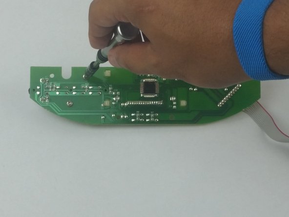

    • Remove the four 11mm Phillips #1 screws from the control panel.

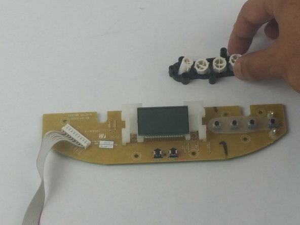

  9. Oster Expressbake CKSTBRTW20 Top Panel Buttons Replacement: crwdns2935265:09crwdnd2935265:01crwdnd2935265:03crwdne2935265:0 Oster Expressbake CKSTBRTW20 Top Panel Buttons Replacement: crwdns2935265:09crwdnd2935265:02crwdnd2935265:03crwdne2935265:0 Oster Expressbake CKSTBRTW20 Top Panel Buttons Replacement: crwdns2935265:09crwdnd2935265:03crwdnd2935265:03crwdne2935265:0
    • Remove the two 11mm Phillips #1 screws from the button panel.
    • Flip the screen assembly over and remove the button panel.

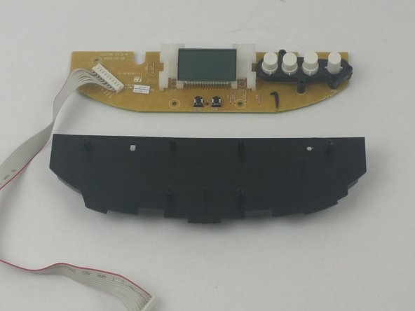

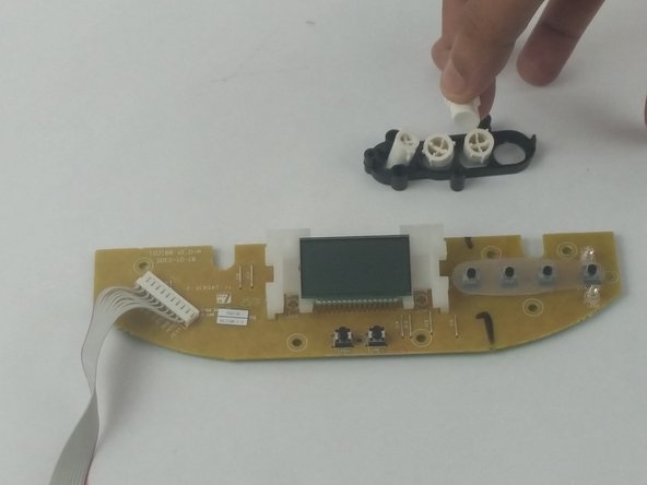

  10. Oster Expressbake CKSTBRTW20 Top Panel Buttons Replacement: crwdns2935265:010crwdnd2935265:01crwdnd2935265:02crwdne2935265:0 Oster Expressbake CKSTBRTW20 Top Panel Buttons Replacement: crwdns2935265:010crwdnd2935265:02crwdnd2935265:02crwdne2935265:0
    • Remove and replace buttons as necessary.
