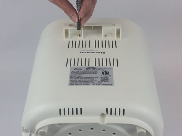

  3. Oster Expressbake CKSTBRTW20 Inner Chamber Replacement: crwdns2935265:03crwdnd2935265:01crwdnd2935265:02crwdne2935265:0 Oster Expressbake CKSTBRTW20 Inner Chamber Replacement: crwdns2935265:03crwdnd2935265:02crwdnd2935265:02crwdne2935265:0
    • Remove the two 11mm Phillips #1 screws from the back of the device.

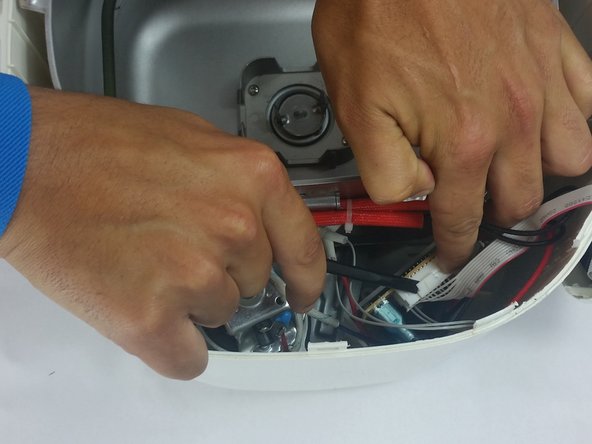

  5. Oster Expressbake CKSTBRTW20 Inner Chamber Replacement, Inner Chamber: crwdns2935265:05crwdnd2935265:01crwdnd2935265:03crwdne2935265:0 Oster Expressbake CKSTBRTW20 Inner Chamber Replacement, Inner Chamber: crwdns2935265:05crwdnd2935265:02crwdnd2935265:03crwdne2935265:0 Oster Expressbake CKSTBRTW20 Inner Chamber Replacement, Inner Chamber: crwdns2935265:05crwdnd2935265:03crwdnd2935265:03crwdne2935265:0
    • Disconnect microcontroller and top lining.
    • Ground yourself prior to disconnecting in order to avoid harming the inner electronics.

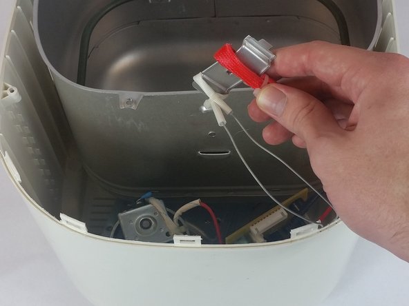

  6. Oster Expressbake CKSTBRTW20 Inner Chamber Replacement: crwdns2935265:06crwdnd2935265:01crwdnd2935265:03crwdne2935265:0 Oster Expressbake CKSTBRTW20 Inner Chamber Replacement: crwdns2935265:06crwdnd2935265:02crwdnd2935265:03crwdne2935265:0 Oster Expressbake CKSTBRTW20 Inner Chamber Replacement: crwdns2935265:06crwdnd2935265:03crwdnd2935265:03crwdne2935265:0

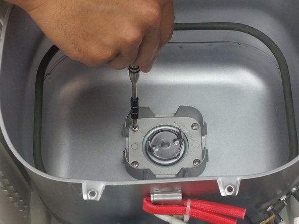

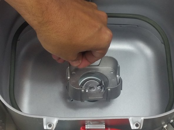

    • Remove the four 11mm Phillips #1 screws holding from the guard and inner lining.
    • Remove small rectangular guard from bottom of liner

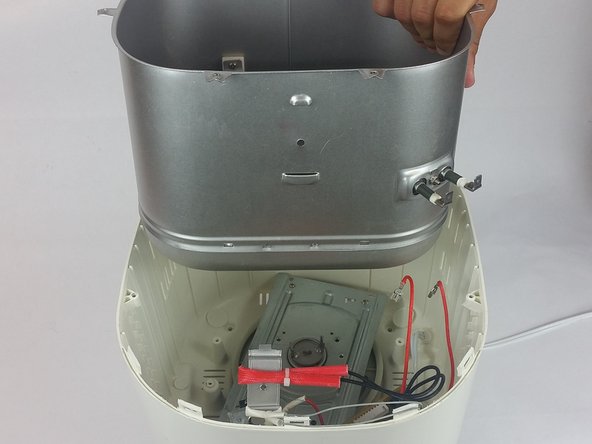

  7. Oster Expressbake CKSTBRTW20 Inner Chamber Replacement: crwdns2935265:07crwdnd2935265:01crwdnd2935265:01crwdne2935265:0
    • Remove the inner liner.
    • The inner liner will be connected to the outer chamber with wires.

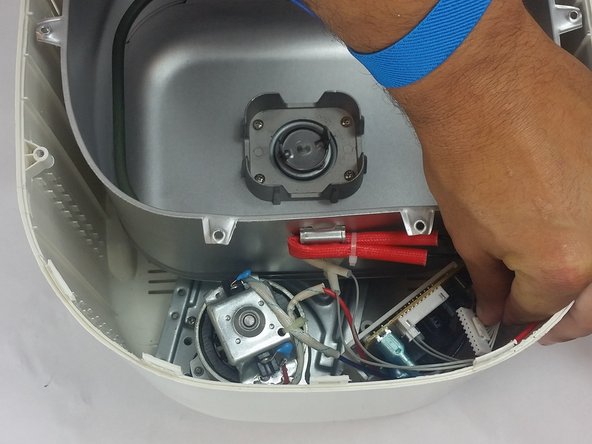

  8. Oster Expressbake CKSTBRTW20 Inner Chamber Replacement: crwdns2935265:08crwdnd2935265:01crwdnd2935265:03crwdne2935265:0 Oster Expressbake CKSTBRTW20 Inner Chamber Replacement: crwdns2935265:08crwdnd2935265:02crwdnd2935265:03crwdne2935265:0 Oster Expressbake CKSTBRTW20 Inner Chamber Replacement: crwdns2935265:08crwdnd2935265:03crwdnd2935265:03crwdne2935265:0

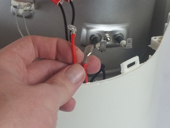

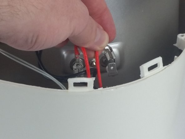

    • Disconnect the red wires from the inner liner.
  9. Oster Expressbake CKSTBRTW20 Inner Chamber Replacement: crwdns2935265:09crwdnd2935265:01crwdnd2935265:02crwdne2935265:0 Oster Expressbake CKSTBRTW20 Inner Chamber Replacement: crwdns2935265:09crwdnd2935265:02crwdnd2935265:02crwdne2935265:0

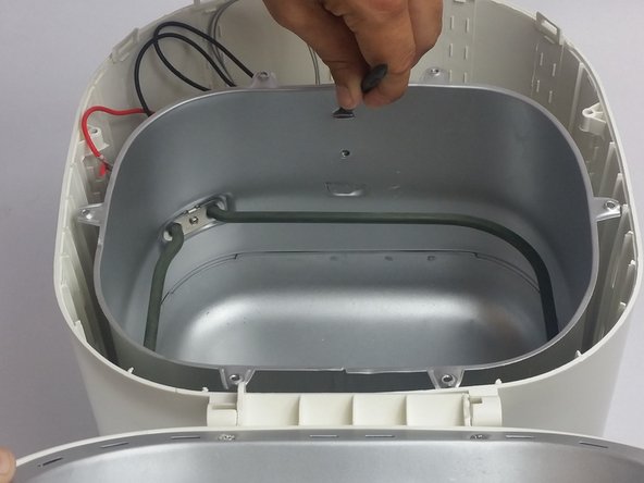

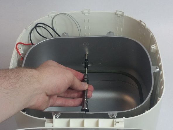

    • Remove the single 11mm Phillips #1 screw thats holding and inner lining in place.
  10. Oster Expressbake CKSTBRTW20 Inner Chamber Replacement: crwdns2935265:010crwdnd2935265:01crwdnd2935265:03crwdne2935265:0 Oster Expressbake CKSTBRTW20 Inner Chamber Replacement: crwdns2935265:010crwdnd2935265:02crwdnd2935265:03crwdne2935265:0 Oster Expressbake CKSTBRTW20 Inner Chamber Replacement: crwdns2935265:010crwdnd2935265:03crwdnd2935265:03crwdne2935265:0
    • Use a spudger to push out the connector found on the inner lining.
  11. Oster Expressbake CKSTBRTW20 Inner Chamber Replacement: crwdns2935265:011crwdnd2935265:01crwdnd2935265:02crwdne2935265:0 Oster Expressbake CKSTBRTW20 Inner Chamber Replacement: crwdns2935265:011crwdnd2935265:02crwdnd2935265:02crwdne2935265:0
    • Remove lining.
