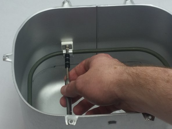

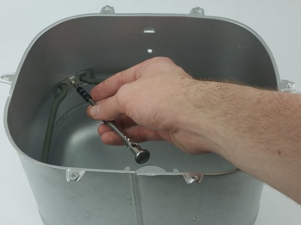

  12. Oster Expressbake CKSTBRTW20 Heating Coils Replacement, Heating Coils: crwdns2935265:012crwdnd2935265:01crwdnd2935265:03crwdne2935265:0 Oster Expressbake CKSTBRTW20 Heating Coils Replacement, Heating Coils: crwdns2935265:012crwdnd2935265:02crwdnd2935265:03crwdne2935265:0 Oster Expressbake CKSTBRTW20 Heating Coils Replacement, Heating Coils: crwdns2935265:012crwdnd2935265:03crwdnd2935265:03crwdne2935265:0
    • Remove the two 11mm Phillips #1 screws from the inside of the chamber.
    • Removal of the screws may also require a 1/4 socket wrench on the other side to prevent spinning.

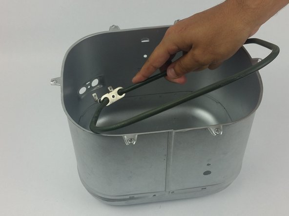

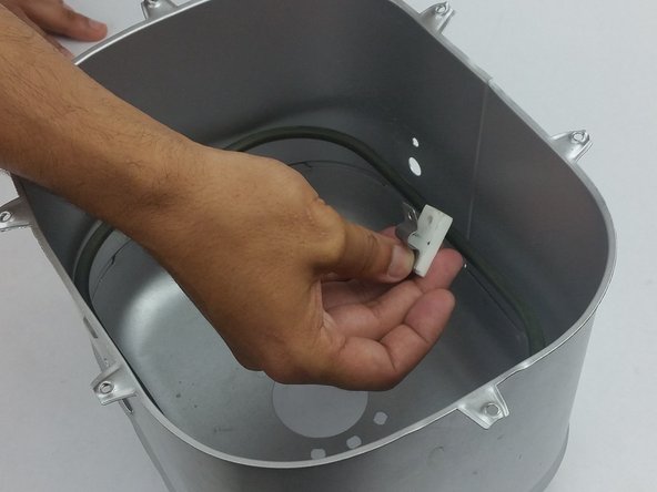

  13. Oster Expressbake CKSTBRTW20 Heating Coils Replacement: crwdns2935265:013crwdnd2935265:01crwdnd2935265:03crwdne2935265:0 Oster Expressbake CKSTBRTW20 Heating Coils Replacement: crwdns2935265:013crwdnd2935265:02crwdnd2935265:03crwdne2935265:0 Oster Expressbake CKSTBRTW20 Heating Coils Replacement: crwdns2935265:013crwdnd2935265:03crwdnd2935265:03crwdne2935265:0
    • Remove the 11mm Phillips #1 screw from the heating coil.
    • After you have removed the screw the coils will pop out of place.
