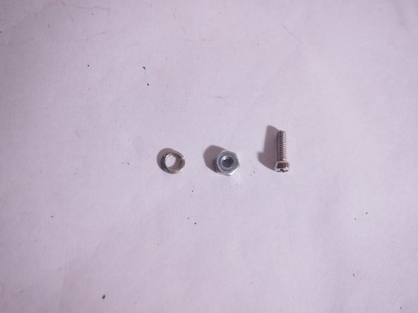

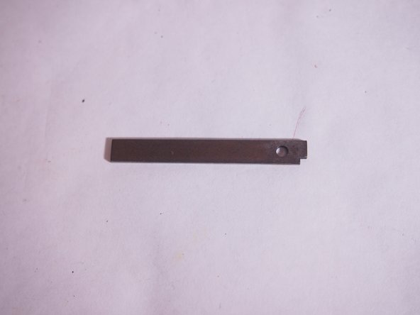

    • Now that you have loosened the clear plastic cube, you'll now move on to the bimetallic strip.
    • This metal strip runs between the switch mechanism.
    • You'll see a screw, fastened with a nut and washer. To remove the strip, unscrew it, and set aside the now free metal piece, screw, nut, and washer.

    • Notice the bimetallic piece from Step 2 letting the gold piece hold the black wedge in the on position.
    • When the device heats up enough to cook the eggs, this bimetallic strip will bend in the direction of the green arrow, pushing the switch back into the off position, and turning the machine off.
