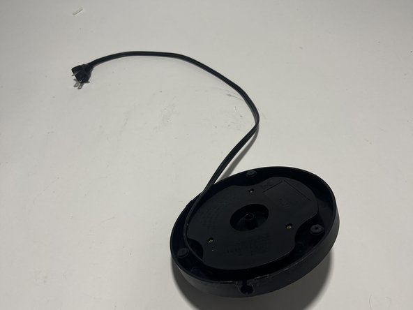

    • Make sure the device is unplugged and free of any liquid.
    • Remove the plastic base at the bottom of the kettle.

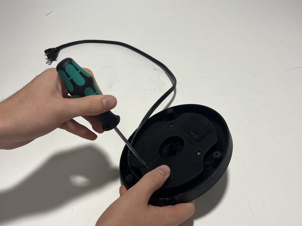

  2. Oster BVST-EK5967 Electric Kettle Disassembly: crwdns2935265:02crwdnd2935265:01crwdnd2935265:02crwdne2935265:0 Oster BVST-EK5967 Electric Kettle Disassembly: crwdns2935265:02crwdnd2935265:02crwdnd2935265:02crwdne2935265:0
    • Remove the four 3 mm screws at the base of the kettle by using the screwdriver.

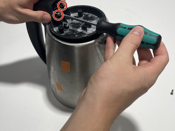

    • Remove the three 3 mm screws near the circular part of the kettle.
  4. Oster BVST-EK5967 Electric Kettle Disassembly: crwdns2935265:04crwdnd2935265:01crwdnd2935265:02crwdne2935265:0 Oster BVST-EK5967 Electric Kettle Disassembly: crwdns2935265:04crwdnd2935265:02crwdnd2935265:02crwdne2935265:0
    • Remove the three 10 mm screws.
  5. Oster BVST-EK5967 Electric Kettle Disassembly: crwdns2935265:05crwdnd2935265:01crwdnd2935265:02crwdne2935265:0 Oster BVST-EK5967 Electric Kettle Disassembly: crwdns2935265:05crwdnd2935265:02crwdnd2935265:02crwdne2935265:0
    • Use a spudger to remove the lid from the top of the kettle.
    • Remove the two 12 mm screws near the temperature reader.
