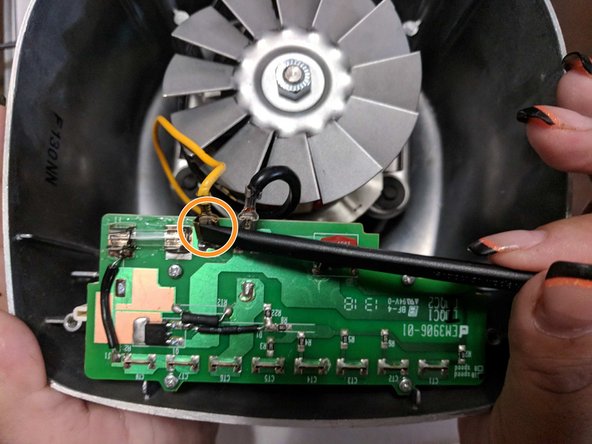

  4. Oster BLSTSS-PZO Gear Shaft Replacement: crwdns2935265:04crwdnd2935265:01crwdnd2935265:02crwdne2935265:0 Oster BLSTSS-PZO Gear Shaft Replacement: crwdns2935265:04crwdnd2935265:02crwdnd2935265:02crwdne2935265:0
    • Use the spudger to detach the black wire from the circuit board.
    • Repeat for yellow wire.

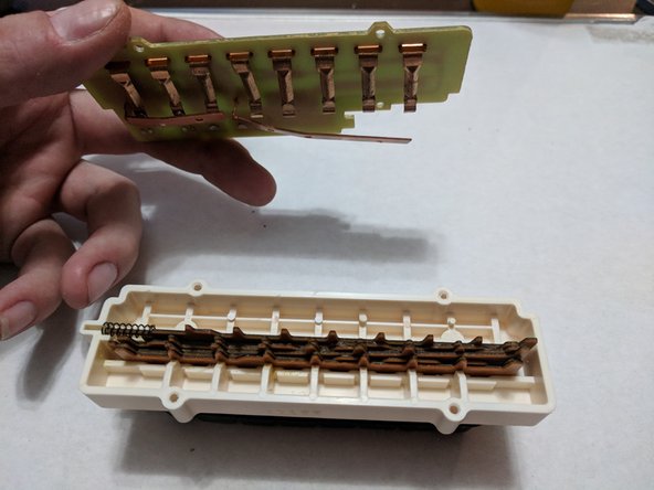

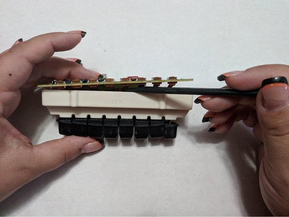

  5. Oster BLSTSS-PZO Gear Shaft Replacement: crwdns2935265:05crwdnd2935265:01crwdnd2935265:03crwdne2935265:0 Oster BLSTSS-PZO Gear Shaft Replacement: crwdns2935265:05crwdnd2935265:02crwdnd2935265:03crwdne2935265:0 Oster BLSTSS-PZO Gear Shaft Replacement: crwdns2935265:05crwdnd2935265:03crwdnd2935265:03crwdne2935265:0
    • Use the Phillips #1 to remove the four 8mm screws.
    • Use the medal spudger to detach the circuit board from the buttons.
    • Gently pull and release circuit board from buttons.

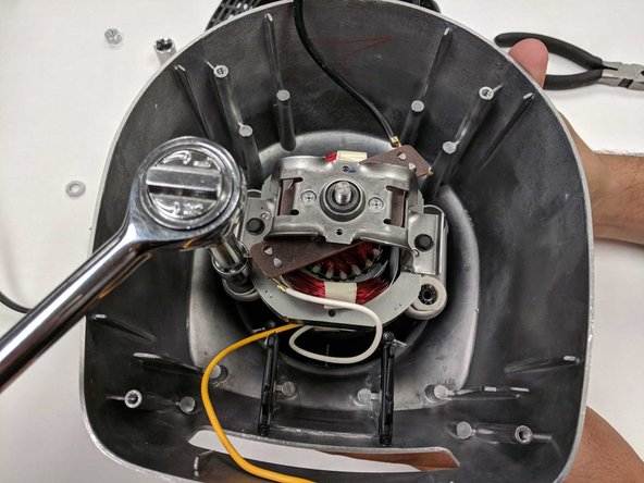

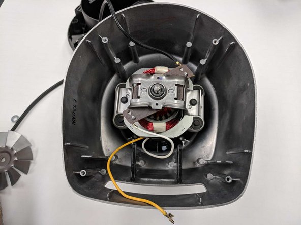

  6. Oster BLSTSS-PZO Gear Shaft Replacement, Gear Shaft: crwdns2935265:06crwdnd2935265:01crwdnd2935265:03crwdne2935265:0 Oster BLSTSS-PZO Gear Shaft Replacement, Gear Shaft: crwdns2935265:06crwdnd2935265:02crwdnd2935265:03crwdne2935265:0 Oster BLSTSS-PZO Gear Shaft Replacement, Gear Shaft: crwdns2935265:06crwdnd2935265:03crwdnd2935265:03crwdne2935265:0
    • Remove the screw on top of the fan with the 4mm socket stock wrench.
    • Remove the fan and washer.

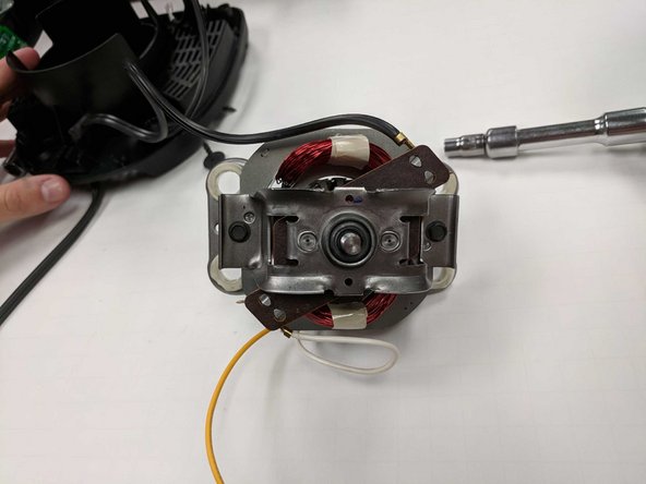

  7. Oster BLSTSS-PZO Gear Shaft Replacement: crwdns2935265:07crwdnd2935265:01crwdnd2935265:03crwdne2935265:0 Oster BLSTSS-PZO Gear Shaft Replacement: crwdns2935265:07crwdnd2935265:02crwdnd2935265:03crwdne2935265:0 Oster BLSTSS-PZO Gear Shaft Replacement: crwdns2935265:07crwdnd2935265:03crwdnd2935265:03crwdne2935265:0
    • Remove the four screws with the 4mm socket stock wrench.
    • Remove gear shaft.
