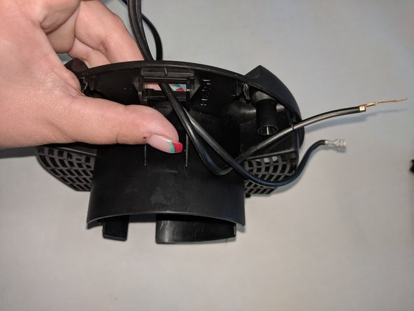

    • Gently remove the circuit board.
  4. Oster BLSTSS-PZO  Power Cord Replacement: crwdns2935265:04crwdnd2935265:01crwdnd2935265:02crwdne2935265:0 Oster BLSTSS-PZO  Power Cord Replacement: crwdns2935265:04crwdnd2935265:02crwdnd2935265:02crwdne2935265:0

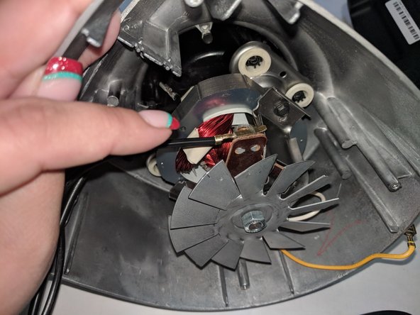

    • Use the spudger to detach the black wire from the circuit board.
    • Repeat for yellow wire.

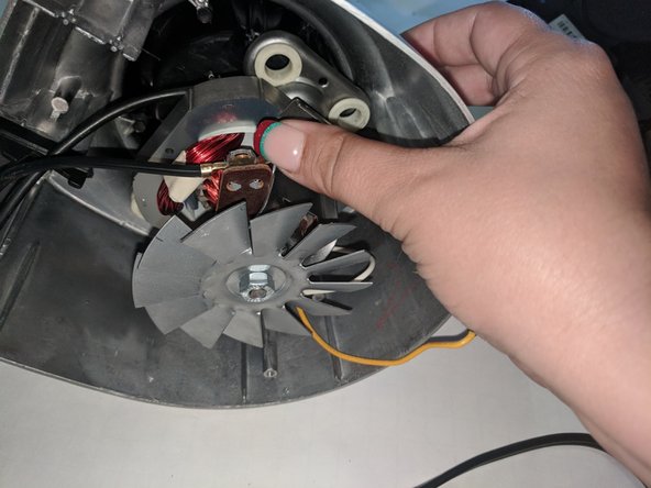

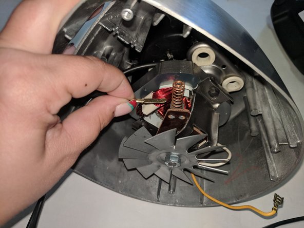

    • Locate petal prong on the end of the power cord.
    • Bend metal prong until it's straight with your finger.
  7. Oster BLSTSS-PZO  Power Cord Replacement: crwdns2935265:07crwdnd2935265:01crwdnd2935265:02crwdne2935265:0 Oster BLSTSS-PZO  Power Cord Replacement: crwdns2935265:07crwdnd2935265:02crwdnd2935265:02crwdne2935265:0
    • Spring will pop out when you pull out metal prong
    • Pull prong out of the hole.

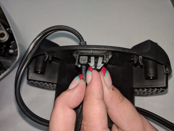

    • Pinch plastic prongs on base of blender to remove plastic securing device.
    • Remove plastic securing device.
    • Pull power cord out of blender base.
