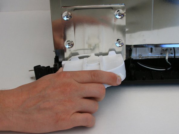

  13. Oster 3905 Retractable Cord Replacement, Retractable Cord: crwdns2935265:013crwdnd2935265:01crwdnd2935265:01crwdne2935265:0
    • Rotate the toaster so that the back is facing towards you.

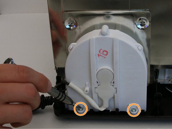

  14. Oster 3905 Retractable Cord Replacement: crwdns2935265:014crwdnd2935265:01crwdnd2935265:02crwdne2935265:0 Oster 3905 Retractable Cord Replacement: crwdns2935265:014crwdnd2935265:02crwdnd2935265:02crwdne2935265:0
    • Use the PH#1 bit to remove one 8mm screw located above the wire on the casing.
    • Then use the same screw bit to remove two 10mm screws found at the bottom.

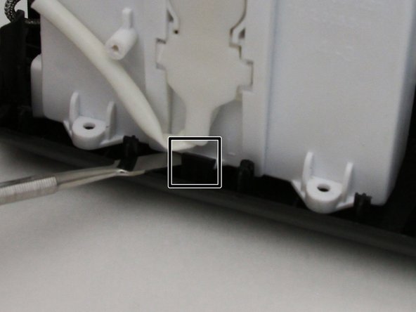

  15. Oster 3905 Retractable Cord Replacement: crwdns2935265:015crwdnd2935265:01crwdnd2935265:02crwdne2935265:0 Oster 3905 Retractable Cord Replacement: crwdns2935265:015crwdnd2935265:02crwdnd2935265:02crwdne2935265:0
    • Using the metal spudger, pry next to the black clip found at the base of the toaster and the casing.
    • Push down to separate the casing from the toaster.

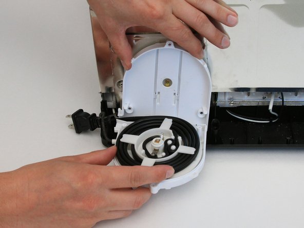

  16. Oster 3905 Retractable Cord Replacement: crwdns2935265:016crwdnd2935265:01crwdnd2935265:02crwdne2935265:0 Oster 3905 Retractable Cord Replacement: crwdns2935265:016crwdnd2935265:02crwdnd2935265:02crwdne2935265:0
    • Gently tilt the casing towards the toaster as you pull up from the base.
  17. Oster 3905 Retractable Cord Replacement: crwdns2935265:017crwdnd2935265:01crwdnd2935265:01crwdne2935265:0
    • Use the PH#1 bit to remove the three 8mm screws located on the back side of the casing.

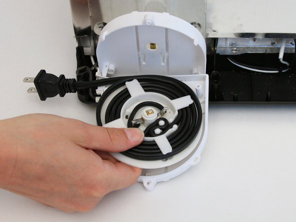

  18. Oster 3905 Retractable Cord Replacement: crwdns2935265:018crwdnd2935265:01crwdnd2935265:02crwdne2935265:0 Oster 3905 Retractable Cord Replacement: crwdns2935265:018crwdnd2935265:02crwdnd2935265:02crwdne2935265:0
    • When opening the casing a metal spring may suddenly pop out.
    • Use the metal spudger to pry open the two halves of the casing.
    • If you are having some trouble only using the metal spudger do not be afraid of using your fingers to pry the casing apart.

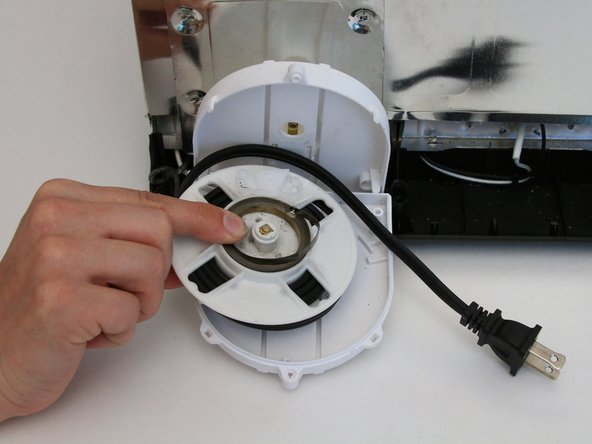

  19. Oster 3905 Retractable Cord Replacement: crwdns2935265:019crwdnd2935265:01crwdnd2935265:03crwdne2935265:0 Oster 3905 Retractable Cord Replacement: crwdns2935265:019crwdnd2935265:02crwdnd2935265:03crwdne2935265:0 Oster 3905 Retractable Cord Replacement: crwdns2935265:019crwdnd2935265:03crwdnd2935265:03crwdne2935265:0
    • Carefully remove the spool keeping your fingers on either side of the casing.
    • Tape down the metal spring to keep it from unraveling out of place.

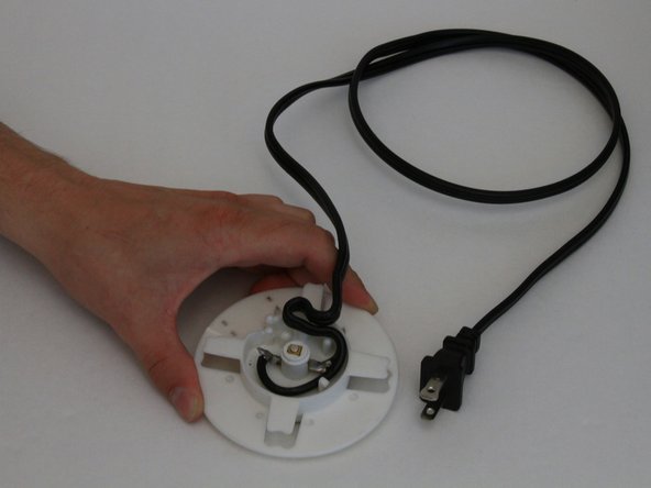

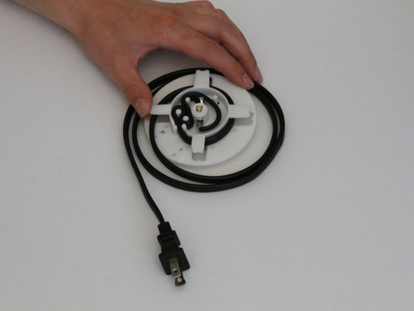

  20. Oster 3905 Retractable Cord Replacement: crwdns2935265:020crwdnd2935265:01crwdnd2935265:03crwdne2935265:0 Oster 3905 Retractable Cord Replacement: crwdns2935265:020crwdnd2935265:02crwdnd2935265:03crwdne2935265:0 Oster 3905 Retractable Cord Replacement: crwdns2935265:020crwdnd2935265:03crwdnd2935265:03crwdne2935265:0
    • Carefully unwind the power cord from the spool.
