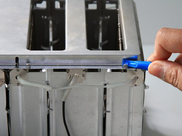

  13. Oster 3905 Lever Spring Replacement, Lever Spring: crwdns2935265:013crwdnd2935265:01crwdnd2935265:02crwdne2935265:0 Oster 3905 Lever Spring Replacement, Lever Spring: crwdns2935265:013crwdnd2935265:02crwdnd2935265:02crwdne2935265:0
    • Use the plastic opening tool to remove the top metal panel by prying the 4 top metal tabs upwards. They will be able to slide through the openings and be pulled upwards.

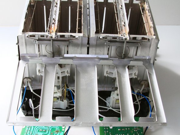

  14. Oster 3905 Lever Spring Replacement: crwdns2935265:014crwdnd2935265:01crwdnd2935265:02crwdne2935265:0 Oster 3905 Lever Spring Replacement: crwdns2935265:014crwdnd2935265:02crwdnd2935265:02crwdne2935265:0
    • Once the top metal panel is unhooked, lift and let it hang off the side of the toaster.

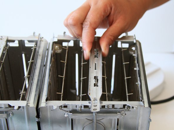

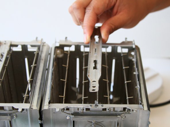

  15. Oster 3905 Lever Spring Replacement: crwdns2935265:015crwdnd2935265:01crwdnd2935265:03crwdne2935265:0 Oster 3905 Lever Spring Replacement: crwdns2935265:015crwdnd2935265:02crwdnd2935265:03crwdne2935265:0 Oster 3905 Lever Spring Replacement: crwdns2935265:015crwdnd2935265:03crwdnd2935265:03crwdne2935265:0
    • Use a metal spudger to pry the 8 tabs upwards along the metal that separates the two slots.
    • Pull the metal spacer upwards to release from the toaster.

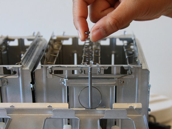

  16. Oster 3905 Lever Spring Replacement: crwdns2935265:016crwdnd2935265:01crwdnd2935265:02crwdne2935265:0 Oster 3905 Lever Spring Replacement: crwdns2935265:016crwdnd2935265:02crwdnd2935265:02crwdne2935265:0
    • Remove the spring wrapped around a metal rod at the front of the toaster, located behind the white plastic lever holder.
