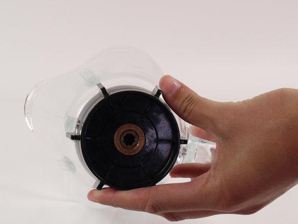

    • Flip the container on its side so that the bottom faces you.
    • Now rotate the bottom counter-clockwise to remove it from the container.

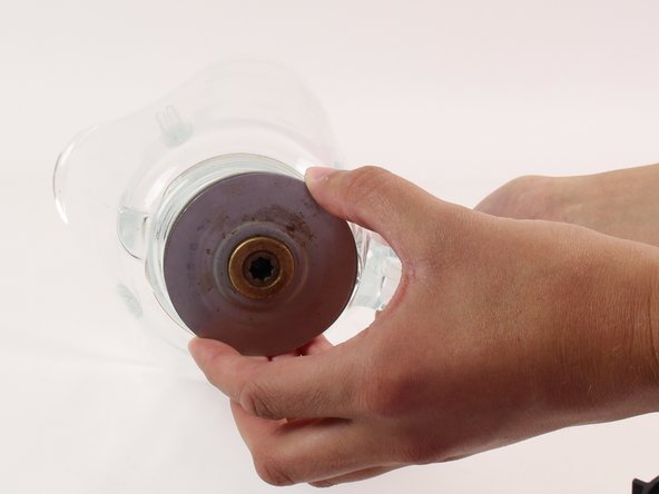

  4. Oster 16-Speed Blender Container Replacement: crwdns2935265:04crwdnd2935265:01crwdnd2935265:02crwdne2935265:0 Oster 16-Speed Blender Container Replacement: crwdns2935265:04crwdnd2935265:02crwdnd2935265:02crwdne2935265:0
    • Now you will see the bottom of the blender blades once the bottom piece is removed
    • Carefully remove the blender blades from the container seeing as they are very sharp and can cut you.
