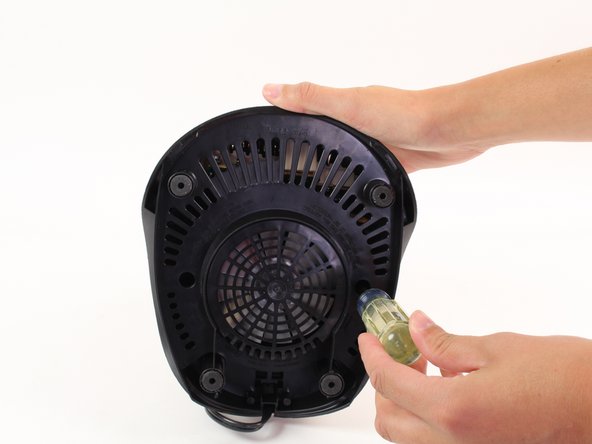

    • Flip the blender so the bottom is facing you.
  3. Oster 16-Speed Blender Circuit Board Replacement: crwdns2935265:03crwdnd2935265:01crwdnd2935265:03crwdne2935265:0 Oster 16-Speed Blender Circuit Board Replacement: crwdns2935265:03crwdnd2935265:02crwdnd2935265:03crwdne2935265:0 Oster 16-Speed Blender Circuit Board Replacement: crwdns2935265:03crwdnd2935265:03crwdnd2935265:03crwdne2935265:0
    • Unscrew the 16mm screws located on the plastic bottom from the blender base using a Phillips #2 screwdriver.
  4. Oster 16-Speed Blender Circuit Board Replacement: crwdns2935265:04crwdnd2935265:01crwdnd2935265:02crwdne2935265:0 Oster 16-Speed Blender Circuit Board Replacement: crwdns2935265:04crwdnd2935265:02crwdnd2935265:02crwdne2935265:0
    • Remove the plastic bottom from the base of the blender.

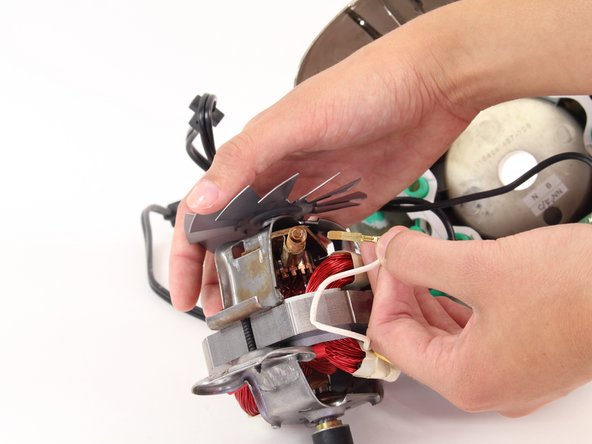

    • Holding the center of the fan, grip the knob in the center of the top of the blender with a wrench and twist the wrench counterclockwise.
  6. Oster 16-Speed Blender Circuit Board Replacement: crwdns2935265:06crwdnd2935265:01crwdnd2935265:01crwdne2935265:0
    • Carefully remove the motor and fan from the base of the blender.
  7. Oster 16-Speed Blender Circuit Board Replacement: crwdns2935265:07crwdnd2935265:01crwdnd2935265:03crwdne2935265:0 Oster 16-Speed Blender Circuit Board Replacement: crwdns2935265:07crwdnd2935265:02crwdnd2935265:03crwdne2935265:0 Oster 16-Speed Blender Circuit Board Replacement: crwdns2935265:07crwdnd2935265:03crwdnd2935265:03crwdne2935265:0

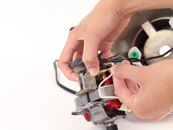

    • Now, gently pull the white wire that is connected to the base and the motor.
    • Be careful, as there is a spring behind the contact points, that might try to shoot out and hurt you.

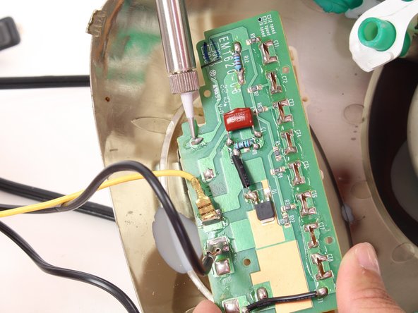

    • Now de-solder the yellow wire from circuit board. De-solder the wire following these instructions.
    • Be careful, as there is another, black wire, nearby that you do not want to de-solder.

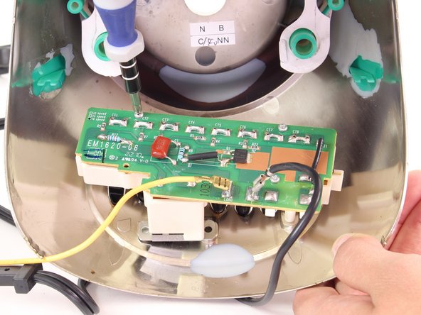

    • Locate the four 11mm screws in the circuit board.
    • Unscrew the four screws using the Phillips #1 screwdriver.

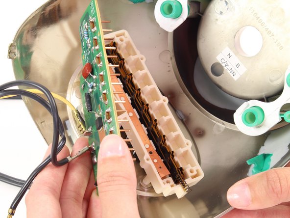

  11. Oster 16-Speed Blender Circuit Board Replacement: crwdns2935265:011crwdnd2935265:01crwdnd2935265:02crwdne2935265:0 Oster 16-Speed Blender Circuit Board Replacement: crwdns2935265:011crwdnd2935265:02crwdnd2935265:02crwdne2935265:0
    • Desolder the circuit board from the base at the indicated point, following the directions by clicking here.
    • Now separate the circuit board from the base.
  12. Oster 16-Speed Blender Circuit Board Replacement: crwdns2935265:012crwdnd2935265:01crwdnd2935265:03crwdne2935265:0 Oster 16-Speed Blender Circuit Board Replacement: crwdns2935265:012crwdnd2935265:02crwdnd2935265:03crwdne2935265:0 Oster 16-Speed Blender Circuit Board Replacement: crwdns2935265:012crwdnd2935265:03crwdnd2935265:03crwdne2935265:0
    • You will see that the circuit board is still attached by a red wire and a black wire.
    • Flip the circuit board back over and desolder at the indicated points following the directions given here.
Now your circuit board is ready to be replaced. To reassemble your device, follow these instructions in reverse order.

So, a question. Where does the spring go? I was fixing one of these and the spring fell out and I never saw where it came from.
Seth Grady - crwdns2934203:0crwdne2934203:0
inside 2 tubes that stick out opposite of each other just below the fan.
dbagarotti -
Spring goes on the one of the strips that slides back and forth....it has small end which goes in a small notched cavity of the plastic housing. Spring goes on that longer end of the stripe. See the picture in step 12...its popped out from the plastic housing.
