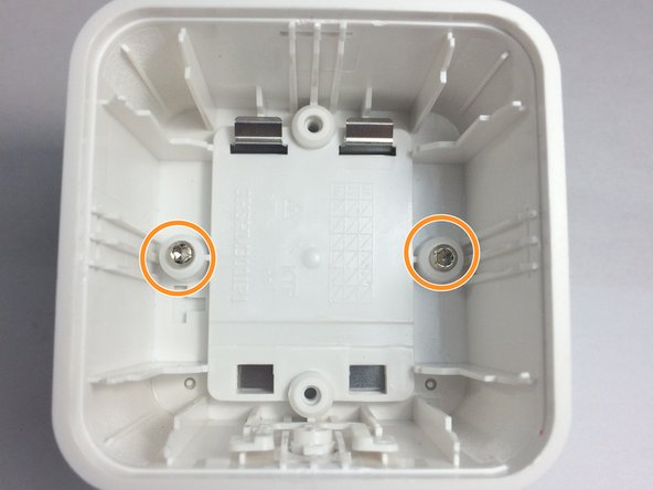

    • Once the PCB is removed, use a Torx T9 screwdriver to unscrew and remove the power supply.
    • Remove the screws holding on the back cover with a Torx T9 screwdriver and remove the back cover.
    • all the screws are the same. they can be mixed with no problem.

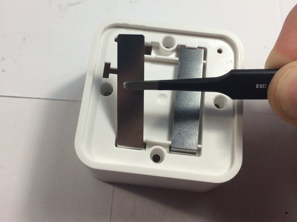

    • Remove the button by grabbing the tab over the button and pulling it out.
    • it will not come out if the button is not depressed.
    • Remove both metal sheets. when its at an angle, push it in a little and then pull it up so that it is pointing straight up. then, you can push it through.
