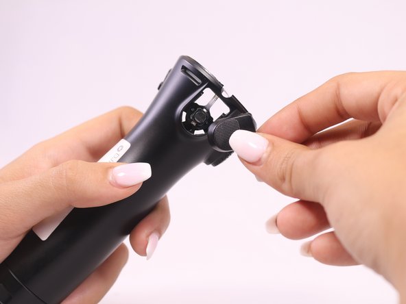

  4. Osmo Mobile Trigger Button Replacement: crwdns2935265:04crwdnd2935265:01crwdnd2935265:02crwdne2935265:0 Osmo Mobile Trigger Button Replacement: crwdns2935265:04crwdnd2935265:02crwdnd2935265:02crwdne2935265:0
    • Remove joystick by gently pulling away from handle
