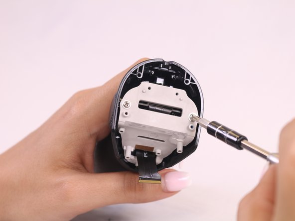

      • Locate and remove the black screw found at the base of the grey mounting plate.
      • Remove the grey face plate.

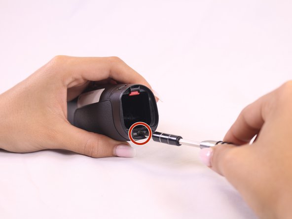

      • Open the battery hatch and remove it by using the tweezers to press the hinge into the device.
      • Remove the black screw located underneath where the battery hatch was.

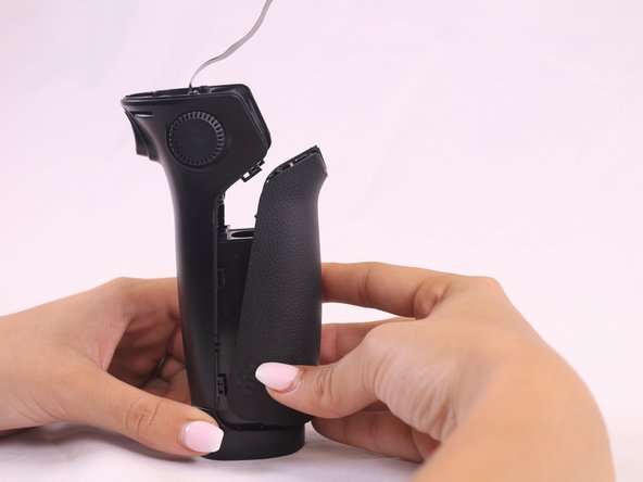

      • Use the spudger to remove the front handle casing by sliding the spudger into the area between the handle grooves.
      • Slide the spudger around the groove to find the 6 clasps that hold the front part of the handle, and unclasp them.
      • Take off the front handle section to reveal the whole interior of the device.

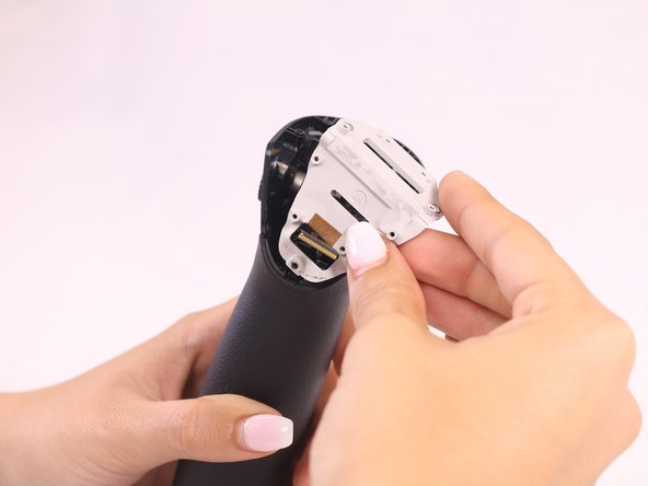

      • Locate and remove the black screw in the center of the motherboard chip.
      • Remove motherboard and replace.
