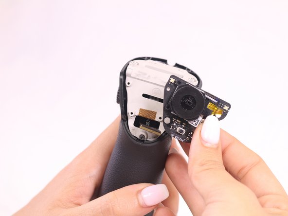

  7. Osmo Mobile Analog JoyStick Replacement, Analog JoyStick: crwdns2935265:07crwdnd2935265:01crwdnd2935265:01crwdne2935265:0
    • Remove the top left screw on the joystick panel with 00 screwdriver.
    • Lift the faceplate holding joystick module.
  8. Osmo Mobile Analog JoyStick Replacement: crwdns2935265:08crwdnd2935265:01crwdnd2935265:01crwdne2935265:0
    • Remove the bottom right screw on the joystick panel with the #00 Phillips screwdriver.
  9. Osmo Mobile Analog JoyStick Replacement: crwdns2935265:09crwdnd2935265:01crwdnd2935265:01crwdne2935265:0
    • Hold down the larger of the two ribbon cables, and pull on the circuit board with a constant and careful down and out motion.
  10. Osmo Mobile Analog JoyStick Replacement: crwdns2935265:010crwdnd2935265:01crwdnd2935265:02crwdne2935265:0 Osmo Mobile Analog JoyStick Replacement: crwdns2935265:010crwdnd2935265:02crwdnd2935265:02crwdne2935265:0
    • Gently remove joystick module by pulling it through the circuit board and inserting the new module.
