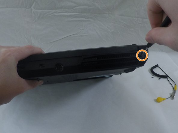

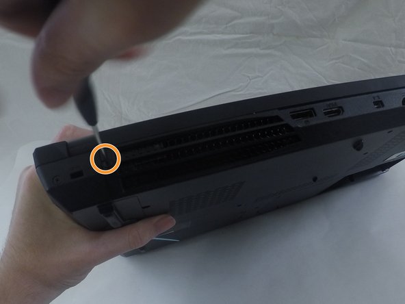

  3. Origin EON17-S mSATA SSDs Replacement: crwdns2935265:03crwdnd2935265:01crwdnd2935265:03crwdne2935265:0 Origin EON17-S mSATA SSDs Replacement: crwdns2935265:03crwdnd2935265:02crwdnd2935265:03crwdne2935265:0 Origin EON17-S mSATA SSDs Replacement: crwdns2935265:03crwdnd2935265:03crwdnd2935265:03crwdne2935265:0
    • Performing the following actions incorrectly can damage your hard drive and could result in lost data. Consider backing up your hard drive(s) before proceeding.
    • Remove the component cover by removing the six screws with a 3/32" screwdriver.
    • Remove the screws from the bottom of the computer.
    • Remove the screws from the back of the computer.

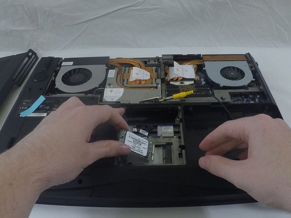

  6. Origin EON17-S mSATA SSDs Replacement: crwdns2935265:06crwdnd2935265:01crwdnd2935265:02crwdne2935265:0 Origin EON17-S mSATA SSDs Replacement: crwdns2935265:06crwdnd2935265:02crwdnd2935265:02crwdne2935265:0
    • You will see the mSATA drive in the lower right hand corner of the component area.
    • Remove the screw on the far right side of the drive.
    • The drive will rise up to an angle.
    • Remove the drive by pulling in the direction the drive is positioned.

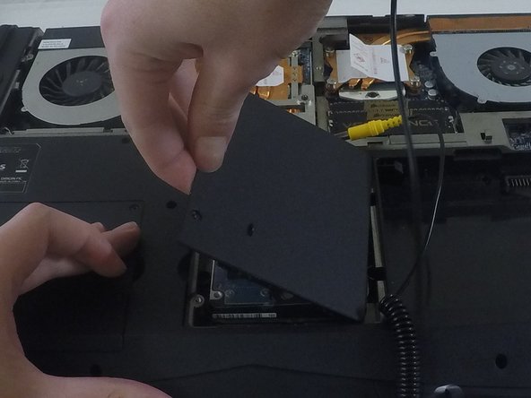

  7. Origin EON17-S mSATA SSDs Replacement: crwdns2935265:07crwdnd2935265:01crwdnd2935265:02crwdne2935265:0 Origin EON17-S mSATA SSDs Replacement: crwdns2935265:07crwdnd2935265:02crwdnd2935265:02crwdne2935265:0
    • Unscrew the two screws holding the hard drive cover to reveal the second mSATA bay.
    • There are two snaps on this cover, pull firmly but carefully to remove it without breaking them.
