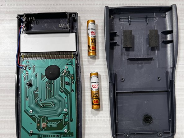

    • Turn off the calculator by pressing the [Shift] button and then press the [AC][OFF] button, (while keeping the [Shift] button pressed down).
  2. Oreva FX-82MS Battery Replacement: crwdns2935265:02crwdnd2935265:01crwdnd2935265:02crwdne2935265:0 Oreva FX-82MS Battery Replacement: crwdns2935265:02crwdnd2935265:02crwdnd2935265:02crwdne2935265:0
    • Flip the calculator over so that the back panel faces up.
    • Use a Phillips #0 screwdriver to remove six, 1.2 mm screws starting from the upper right corner.
  3. Oreva FX-82MS Battery Replacement: crwdns2935265:03crwdnd2935265:01crwdnd2935265:02crwdne2935265:0 Oreva FX-82MS Battery Replacement: crwdns2935265:03crwdnd2935265:02crwdnd2935265:02crwdne2935265:0
    • Remove the back cover and put it to the side.
  4. Oreva FX-82MS Battery Replacement: crwdns2935265:04crwdnd2935265:01crwdnd2935265:02crwdne2935265:0 Oreva FX-82MS Battery Replacement: crwdns2935265:04crwdnd2935265:02crwdnd2935265:02crwdne2935265:0
    • Remove the two old batteries from the slots.
    • Be gentle when removing the batteries to avoid damaging the connectors.
  5. Oreva FX-82MS Battery Replacement: crwdns2935265:05crwdnd2935265:01crwdnd2935265:03crwdne2935265:0 Oreva FX-82MS Battery Replacement: crwdns2935265:05crwdnd2935265:02crwdnd2935265:03crwdne2935265:0 Oreva FX-82MS Battery Replacement: crwdns2935265:05crwdnd2935265:03crwdnd2935265:03crwdne2935265:0
    • Place the two new AAA batteries into the calculator, one by one.
    • Be sure that the direction of the + and - signs on your battery match the signs at the bottom of the battery compartment.
    • Place the case on back of the calculator.
  6. Oreva FX-82MS Battery Replacement: crwdns2935265:06crwdnd2935265:01crwdnd2935265:02crwdne2935265:0 Oreva FX-82MS Battery Replacement: crwdns2935265:06crwdnd2935265:02crwdnd2935265:02crwdne2935265:0
    • Use a Phillips #0 screwdriver to replace the 1.2 mm screws on the back case.
  7. Oreva FX-82MS Battery Replacement: crwdns2935265:07crwdnd2935265:01crwdnd2935265:01crwdne2935265:0
    • Reset the calculator by pressing [ON].
    • Press the [shift] button.
    • Press the [9] [CLR] button to clear the data.
    • Press the [3][ALL] button option.
    • Press [=] [yes] button to agree.
    • Press [AC] key to reset.
