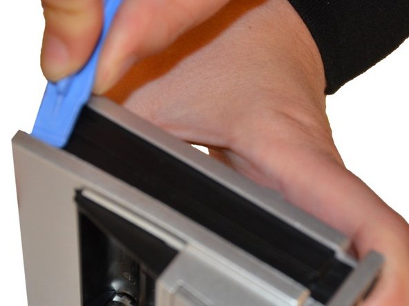

    3. Oregon Scientific RM318PA Power Switch Replacement, Back of Projection Clock: crwdns2935265:03crwdnd2935265:01crwdnd2935265:03crwdne2935265:0 Oregon Scientific RM318PA Power Switch Replacement, Back of Projection Clock: crwdns2935265:03crwdnd2935265:02crwdnd2935265:03crwdne2935265:0 Oregon Scientific RM318PA Power Switch Replacement, Back of Projection Clock: crwdns2935265:03crwdnd2935265:03crwdnd2935265:03crwdne2935265:0
      • Use a Plastic Opening Tool to pry off the silver casing on the back.
      • Pry at the top of device.
      • Once the back is open at the top, pry at the side of the device closest to the battery compartment.
      • On/Off switch should come off with casing.

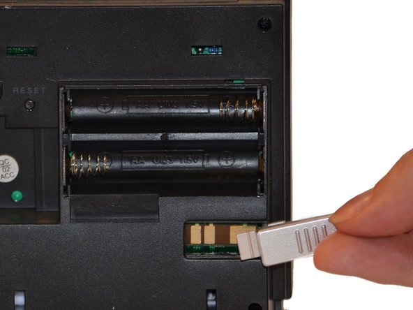

    4. Oregon Scientific RM318PA Power Switch Replacement, On/Off Switch: crwdns2935265:04crwdnd2935265:01crwdnd2935265:02crwdne2935265:0 Oregon Scientific RM318PA Power Switch Replacement, On/Off Switch: crwdns2935265:04crwdnd2935265:02crwdnd2935265:02crwdne2935265:0
      • Insert switch into slot as shown in picture. Push in until you hear a "click."
      • Replace the back of the clock by pressing cover back into place.
