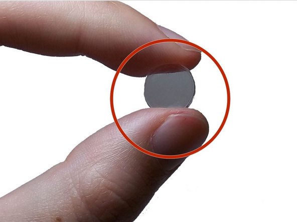

    7. Oregon Scientific RM318PA Lens Replacement, The Lens: crwdns2935265:07crwdnd2935265:01crwdnd2935265:01crwdne2935265:0
      • The Lens is attached to the Focus Knob and is now accessible for replacement purposes.
    8. Oregon Scientific RM318PA Lens Replacement, Tape: crwdns2935265:08crwdnd2935265:01crwdnd2935265:01crwdne2935265:0
      • Apply tape to the lens for safe removal and prevention of injury.
    9. Oregon Scientific RM318PA Lens Replacement, Focus Knob: crwdns2935265:09crwdnd2935265:01crwdnd2935265:02crwdne2935265:0 Oregon Scientific RM318PA Lens Replacement, Focus Knob: crwdns2935265:09crwdnd2935265:02crwdnd2935265:02crwdne2935265:0
      • Detach the focus knob from the internal casing of the lens by removing the screw from the base of the focus knob grip.
      • Pry apart the pieces of casing holding the focus knob in place and remove the knob.
    10. Oregon Scientific RM318PA Lens Replacement, Internal Casing: crwdns2935265:010crwdnd2935265:01crwdnd2935265:03crwdne2935265:0 Oregon Scientific RM318PA Lens Replacement, Internal Casing: crwdns2935265:010crwdnd2935265:02crwdnd2935265:03crwdne2935265:0 Oregon Scientific RM318PA Lens Replacement, Internal Casing: crwdns2935265:010crwdnd2935265:03crwdnd2935265:03crwdne2935265:0
      • Insert the spudger into the opening above the hinge on the side of the casing.
      • Press down firmly until the case opens.
    11. Oregon Scientific RM318PA Lens Replacement, Lens Removal: crwdns2935265:011crwdnd2935265:01crwdnd2935265:02crwdne2935265:0 Oregon Scientific RM318PA Lens Replacement, Lens Removal: crwdns2935265:011crwdnd2935265:02crwdnd2935265:02crwdne2935265:0
      • Pull apart the casing and gently slide lens from pocket.
      • Be sure to replace with a concave lens.
