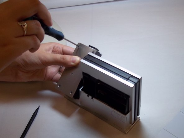

  3. Oregon Scientific RM318PA Focus Knob Replacement, Projection Arm: crwdns2935265:03crwdnd2935265:01crwdnd2935265:03crwdne2935265:0 Oregon Scientific RM318PA Focus Knob Replacement, Projection Arm: crwdns2935265:03crwdnd2935265:02crwdnd2935265:03crwdne2935265:0 Oregon Scientific RM318PA Focus Knob Replacement, Projection Arm: crwdns2935265:03crwdnd2935265:03crwdnd2935265:03crwdne2935265:0
    • Use a Phillips #00 Screwdriver to remove the four (4) screws from the back of the projection arm.
    • Once screws are removed, lift the back up and off of the projection arm.

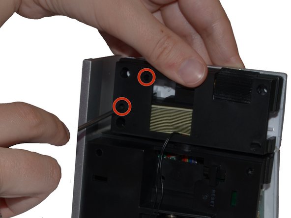

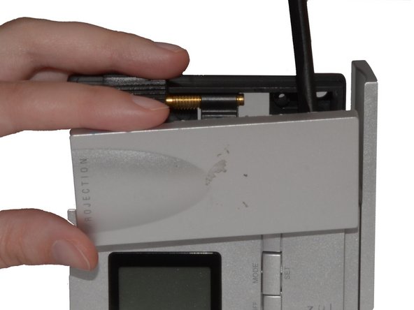

  4. Oregon Scientific RM318PA Focus Knob Replacement: crwdns2935265:04crwdnd2935265:01crwdnd2935265:02crwdne2935265:0 Oregon Scientific RM318PA Focus Knob Replacement: crwdns2935265:04crwdnd2935265:02crwdnd2935265:02crwdne2935265:0
    • Use a Phillips #00 Screwdriver to remove two (2) screws from back of projection arm.
  5. Oregon Scientific RM318PA Focus Knob Replacement: crwdns2935265:05crwdnd2935265:01crwdnd2935265:02crwdne2935265:0 Oregon Scientific RM318PA Focus Knob Replacement: crwdns2935265:05crwdnd2935265:02crwdnd2935265:02crwdne2935265:0

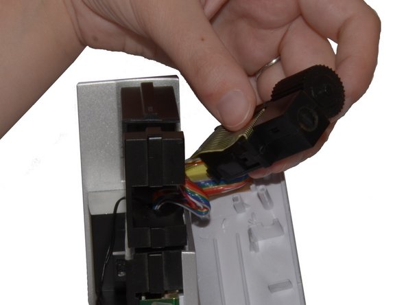

    • Use a plastic opening tool to pry apart the front of the projection arm casing. Start at the top of the projection arm.
    • Once top is partially open, use a spudger to pry at the side of the projection arm.

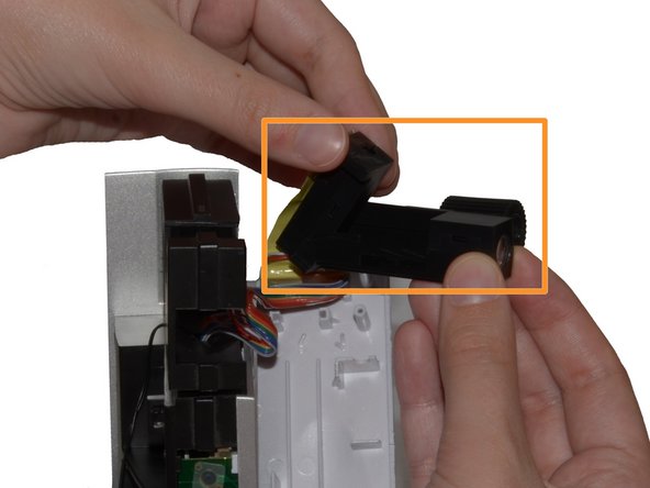

  6. Oregon Scientific RM318PA Focus Knob Replacement, Focus Knob: crwdns2935265:06crwdnd2935265:01crwdnd2935265:03crwdne2935265:0 Oregon Scientific RM318PA Focus Knob Replacement, Focus Knob: crwdns2935265:06crwdnd2935265:02crwdnd2935265:03crwdne2935265:0 Oregon Scientific RM318PA Focus Knob Replacement, Focus Knob: crwdns2935265:06crwdnd2935265:03crwdnd2935265:03crwdne2935265:0
    • Turn the clock on its side. Slide the Focus Knob forward with your thumb.
    • The Focus Knob Component should now be free of Projection Arm.
    • Hold the Component in one hand and lift the Projection Beam up and away from the Focus Knob.

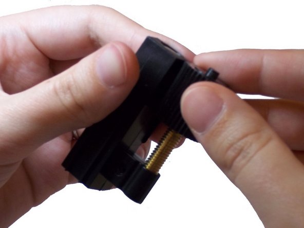

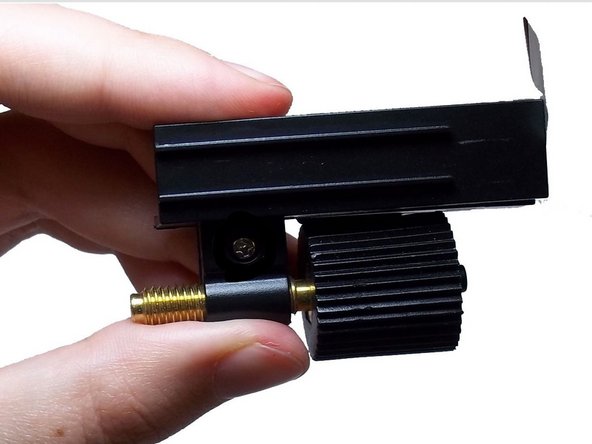

  7. Oregon Scientific RM318PA Focus Knob Replacement: crwdns2935265:07crwdnd2935265:01crwdnd2935265:03crwdne2935265:0 Oregon Scientific RM318PA Focus Knob Replacement: crwdns2935265:07crwdnd2935265:02crwdnd2935265:03crwdne2935265:0 Oregon Scientific RM318PA Focus Knob Replacement: crwdns2935265:07crwdnd2935265:03crwdnd2935265:03crwdne2935265:0
    • Loosen Focus Knob by turning the Focus Knob counterclockwise with your fingers.
    • If needed, add a SMALL amount of WD-40 to the base of the knob and continue turning Focus Knob.
    • Place replacement Focus Knob in socket and turn clockwise to secure.
