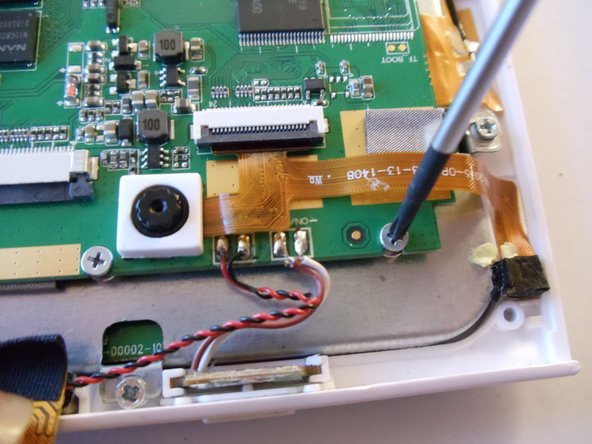

  10. Oregon Scientific Meep! X2 Screen Sensor Replacement: crwdns2935265:010crwdnd2935265:01crwdnd2935265:01crwdne2935265:0
    • Release the black security clip on the ribbon cable with your plastic opening tool.
    • Gently disconnect the gold ribbon cable from the motherboard. The two cameras will remain attached to the ribbon cable.
  11. Oregon Scientific Meep! X2 Screen Sensor Replacement, Motherboard: crwdns2935265:011crwdnd2935265:01crwdnd2935265:02crwdne2935265:0 Oregon Scientific Meep! X2 Screen Sensor Replacement, Motherboard: crwdns2935265:011crwdnd2935265:02crwdnd2935265:02crwdne2935265:0
    • Undo the security clips on the ribbon cable connection by placing the plastic opening tool between the black and white parts of the clip. Pull downard toward the gold ribbon cable.
    • Once the left and right clips are undone, remove the gold ribbon cable from that connection by gently pulling it out.
  12. Oregon Scientific Meep! X2 Screen Sensor Replacement: crwdns2935265:012crwdnd2935265:01crwdnd2935265:02crwdne2935265:0 Oregon Scientific Meep! X2 Screen Sensor Replacement: crwdns2935265:012crwdnd2935265:02crwdnd2935265:02crwdne2935265:0
    • Remove the two phillips #00 (4.5mm x 3mm)screws located on the motherboard.
  13. Oregon Scientific Meep! X2 Screen Sensor Replacement: crwdns2935265:013crwdnd2935265:01crwdnd2935265:02crwdne2935265:0 Oregon Scientific Meep! X2 Screen Sensor Replacement: crwdns2935265:013crwdnd2935265:02crwdnd2935265:02crwdne2935265:0
    • Lift the silver, rectangular blocker in order to expose the right phillips screw #00 (4mm x 3.5mm).
    • Unscrew the left and right phillips #00 (4mm x 3.5mm)screws.
    • Once unscrewed, gently lift the motherboard from the rest of the device.
