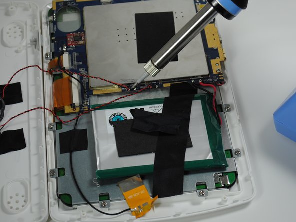

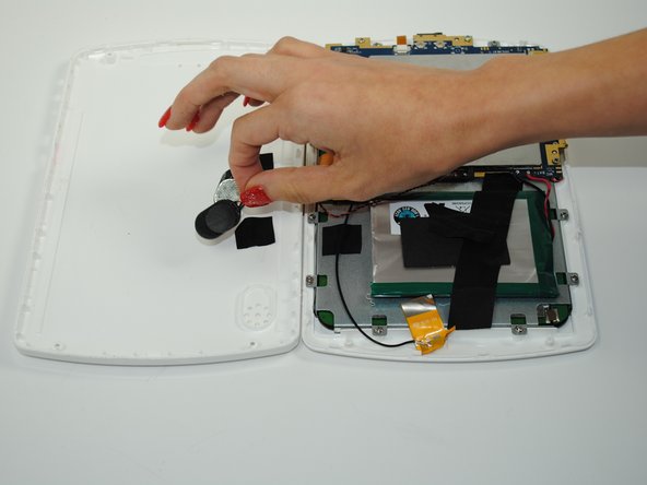

    • Remove the electric tape holding the wires of the speakers in place and gently pull the speakers out of their slots in the device.
  4. Oregon Scientific Meep! 4.0 Speakers Replacement: crwdns2935265:04crwdnd2935265:01crwdnd2935265:02crwdne2935265:0 Oregon Scientific Meep! 4.0 Speakers Replacement: crwdns2935265:04crwdnd2935265:02crwdnd2935265:02crwdne2935265:0
    • Use a soldering station to separate the wires from the speakers.
