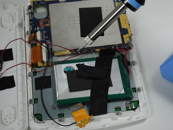

    • Use a screwdriver to remove the four 7.0 mm Philips #00 screws from the back of the device.
  2. Oregon Scientific Meep! 4.0 Motherboard Replacement: crwdns2935265:02crwdnd2935265:01crwdnd2935265:01crwdne2935265:0
    • Use a plastic opening tool to detach the clips on the inside of the device.
  3. Oregon Scientific Meep! 4.0 Motherboard Replacement, Motherboard: crwdns2935265:03crwdnd2935265:01crwdnd2935265:02crwdne2935265:0 Oregon Scientific Meep! 4.0 Motherboard Replacement, Motherboard: crwdns2935265:03crwdnd2935265:02crwdnd2935265:02crwdne2935265:0
    • Use a soldering station to disconnect any wires attached to the motherboard.
  4. Oregon Scientific Meep! 4.0 Motherboard Replacement: crwdns2935265:04crwdnd2935265:01crwdnd2935265:01crwdne2935265:0
    • Use a screwdriver to unscrew the three 4.0 mm Philips #00 screws holding the motherboard in place.
  5. Oregon Scientific Meep! 4.0 Motherboard Replacement: crwdns2935265:05crwdnd2935265:01crwdnd2935265:01crwdne2935265:0
    • Use a plastic opening tool to release the ribbon cables surrounding the motherboard.
