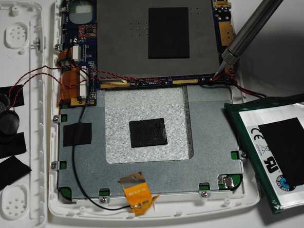

    • Use a screwdriver to remove the four 7.0 mm Philips #00 screws from the back of the device.
  2. Oregon Scientific Meep! 4.0 Battery Replacement: crwdns2935265:02crwdnd2935265:01crwdnd2935265:01crwdne2935265:0
    • Use a plastic opening tool to detach the clips on the inside of the device.
  3. Oregon Scientific Meep! 4.0 Battery Replacement, Battery: crwdns2935265:03crwdnd2935265:01crwdnd2935265:01crwdne2935265:0
    • Remove the black tape holding the battery in place.
  4. Oregon Scientific Meep! 4.0 Battery Replacement: crwdns2935265:04crwdnd2935265:01crwdnd2935265:01crwdne2935265:0
    • Use a spudger to separate the battery from its adhesive.
  5. Oregon Scientific Meep! 4.0 Battery Replacement: crwdns2935265:05crwdnd2935265:01crwdnd2935265:02crwdne2935265:0 Oregon Scientific Meep! 4.0 Battery Replacement: crwdns2935265:05crwdnd2935265:02crwdnd2935265:02crwdne2935265:0
    • Use a soldering station to separate the battery from its connecting wires.
