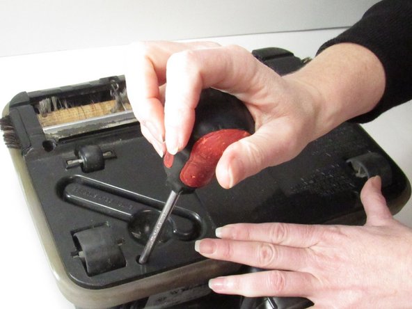

    • Using a Phillips-head screwdriver, remove the five screws from the bottom cover.

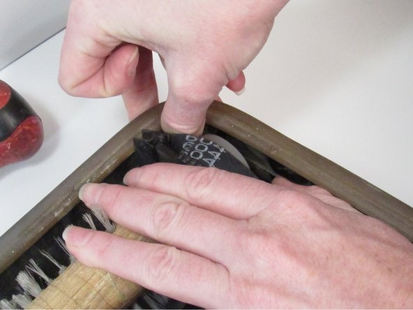

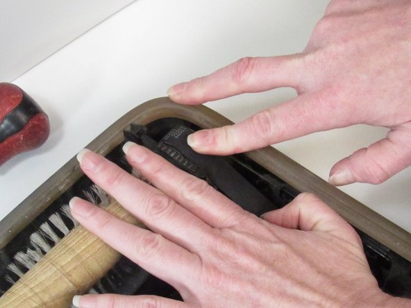

    • Caution: The area around the roller is a pinch point. Be aware of your fingers at all times so you don't get caught or pinched.
    • Remove the belt from the roller.
    • The roller is connected to the brush at the front of the vacuum.
    • Slowly pull the belt off. If you have difficulty, spin the roller as you remove the belt.

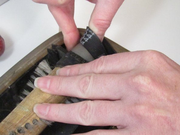

  4. Oreck XL Upright Vacuum Belt Replacement: crwdns2935265:04crwdnd2935265:01crwdnd2935265:01crwdne2935265:0
    • Pull the other side of the belt off of the motor shaft.
    • There is a small opening between the motor shaft and the side of the vacuum. The belt comes out here.
    • Discard the old belt.

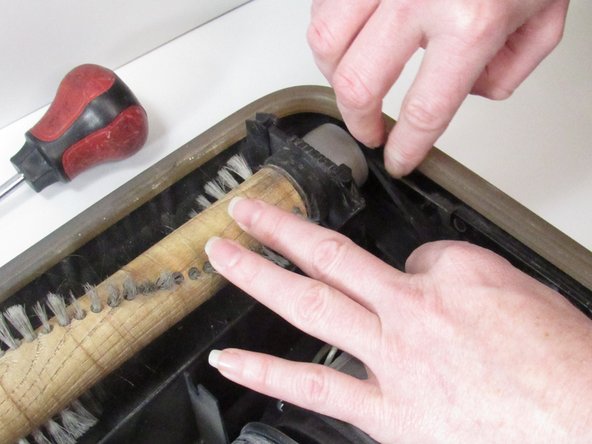

  5. Oreck XL Upright Vacuum Belt Replacement: crwdns2935265:05crwdnd2935265:01crwdnd2935265:01crwdne2935265:0
    • Insert the replacement belt around the motor shaft.

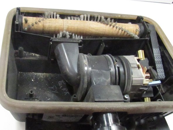

  6. Oreck XL Upright Vacuum Belt Replacement: crwdns2935265:06crwdnd2935265:01crwdnd2935265:03crwdne2935265:0 Oreck XL Upright Vacuum Belt Replacement: crwdns2935265:06crwdnd2935265:02crwdnd2935265:03crwdne2935265:0 Oreck XL Upright Vacuum Belt Replacement: crwdns2935265:06crwdnd2935265:03crwdnd2935265:03crwdne2935265:0
    • Carefully stretch the other end of the belt around the roller.
    • Spin the roller a few times to ensure the belt is secured.
