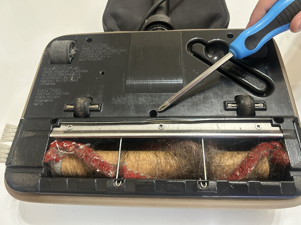

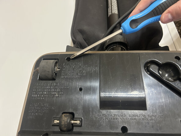

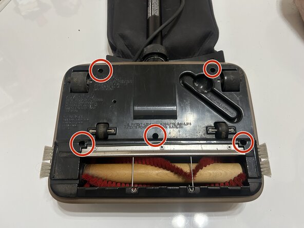

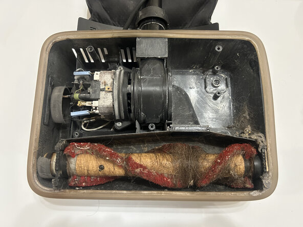

    • Remove five screws with a long neck Phillips #2 screwdriver.

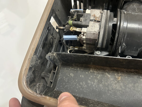

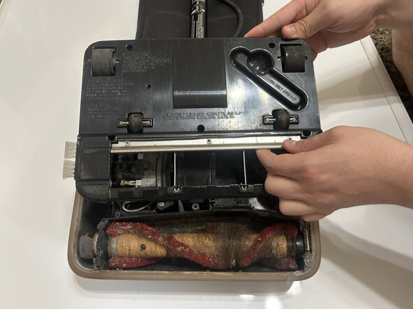

  2. Oreck XL U4120H2 Beater Bar/Agitator and Belt Replacement: crwdns2935265:02crwdnd2935265:01crwdnd2935265:03crwdne2935265:0 Oreck XL U4120H2 Beater Bar/Agitator and Belt Replacement: crwdns2935265:02crwdnd2935265:02crwdnd2935265:03crwdne2935265:0 Oreck XL U4120H2 Beater Bar/Agitator and Belt Replacement: crwdns2935265:02crwdnd2935265:03crwdnd2935265:03crwdne2935265:0

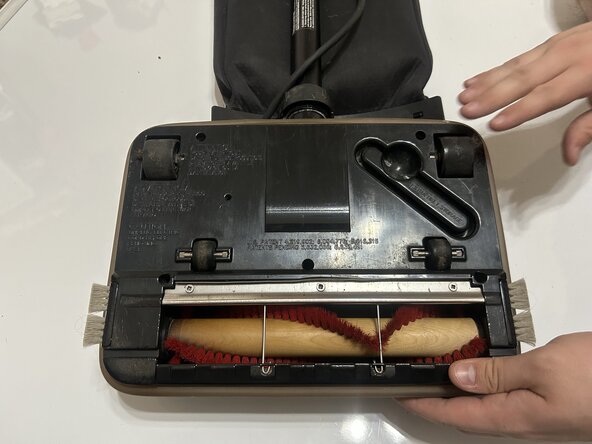

    • Remove the cover by lifting straight up.
    • Be sure to gently remove in case of bending the plastic.

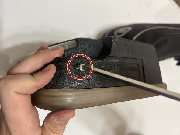

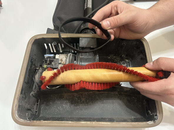

  3. Oreck XL U4120H2 Beater Bar/Agitator and Belt Replacement: crwdns2935265:03crwdnd2935265:01crwdnd2935265:02crwdne2935265:0 Oreck XL U4120H2 Beater Bar/Agitator and Belt Replacement: crwdns2935265:03crwdnd2935265:02crwdnd2935265:02crwdne2935265:0

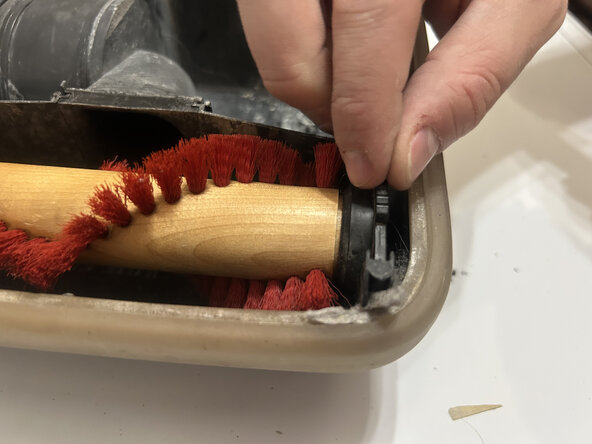

    • Next remove the agitator and belt.
    • Pull the belt out first so it is easier to lift up the agitator.
    • Retrieve the new beater bar and belt.

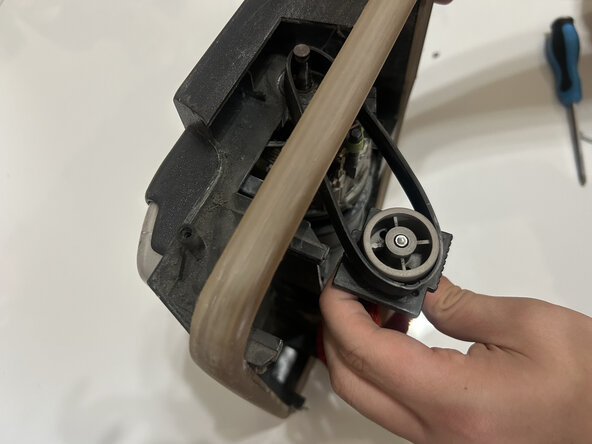

  4. Oreck XL U4120H2 Beater Bar/Agitator and Belt Replacement: crwdns2935265:04crwdnd2935265:01crwdnd2935265:03crwdne2935265:0 Oreck XL U4120H2 Beater Bar/Agitator and Belt Replacement: crwdns2935265:04crwdnd2935265:02crwdnd2935265:03crwdne2935265:0 Oreck XL U4120H2 Beater Bar/Agitator and Belt Replacement: crwdns2935265:04crwdnd2935265:03crwdnd2935265:03crwdne2935265:0
    • If it is difficult to remove the belt, remove the side panel first.
    • Remove the screw and slide the panel to remove it.
  5. Oreck XL U4120H2 Beater Bar/Agitator and Belt Replacement: crwdns2935265:05crwdnd2935265:01crwdnd2935265:03crwdne2935265:0 Oreck XL U4120H2 Beater Bar/Agitator and Belt Replacement: crwdns2935265:05crwdnd2935265:02crwdnd2935265:03crwdne2935265:0 Oreck XL U4120H2 Beater Bar/Agitator and Belt Replacement: crwdns2935265:05crwdnd2935265:03crwdnd2935265:03crwdne2935265:0

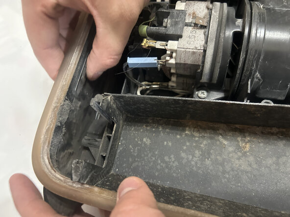

    • Connect the belt to the motor.
    • Attach the other side to the beater bar.
    • Slowly pull the beater bar into the grooves and push it down.
    • To make the process easier be sure to stretch the belt out manually before replacing.

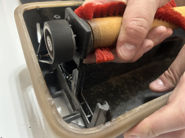

  6. Oreck XL U4120H2 Beater Bar/Agitator and Belt Replacement: crwdns2935265:06crwdnd2935265:01crwdnd2935265:02crwdne2935265:0 Oreck XL U4120H2 Beater Bar/Agitator and Belt Replacement: crwdns2935265:06crwdnd2935265:02crwdnd2935265:02crwdne2935265:0
    • Make sure it is secure in both sides.
  7. Oreck XL U4120H2 Beater Bar/Agitator and Belt Replacement: crwdns2935265:07crwdnd2935265:01crwdnd2935265:02crwdne2935265:0 Oreck XL U4120H2 Beater Bar/Agitator and Belt Replacement: crwdns2935265:07crwdnd2935265:02crwdnd2935265:02crwdne2935265:0
    • Slide the side panel back on and tighten the screw.
  8. Oreck XL U4120H2 Beater Bar/Agitator and Belt Replacement: crwdns2935265:08crwdnd2935265:01crwdnd2935265:03crwdne2935265:0 Oreck XL U4120H2 Beater Bar/Agitator and Belt Replacement: crwdns2935265:08crwdnd2935265:02crwdnd2935265:03crwdne2935265:0 Oreck XL U4120H2 Beater Bar/Agitator and Belt Replacement: crwdns2935265:08crwdnd2935265:03crwdnd2935265:03crwdne2935265:0
    • Place the bottom back on the vacuum.
    • Screw in all five of the Phillips #2 screws to reassemble your vacuum.
