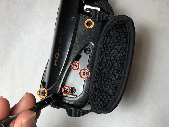

    • Remove plastic casing hiding screws from the strap side of the casing.
    • Unscrew the three screws (length 4.75 mm) using a PH000 screwdriver.
    • Unscrew the two screws (length 6.4 mm) using a JIS000 screwdriver.

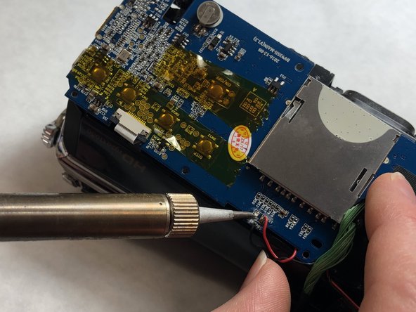

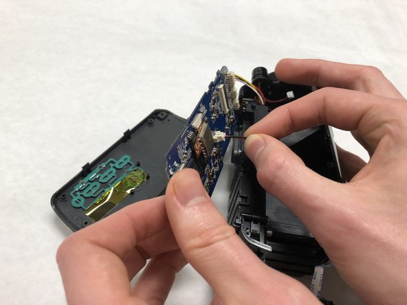

    • Although it requires extra steps, it is advised that you remove the motherboard and screen to ensure that nothing is damaged in the process of replacing the lens.
    • Unscrew the seven screws (length 4.22 mm) from the motherboard using a PH000 screwdriver.
    • Pull out or desolder all connected cords from motherboard.

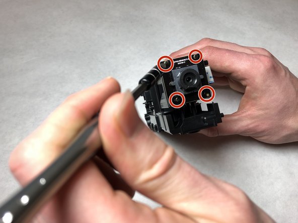

    • Remove top of the casing to reveal the screws on lens.
    • Unscrew the four screws (size 4.90 mm) using a PH00 screwdriver.

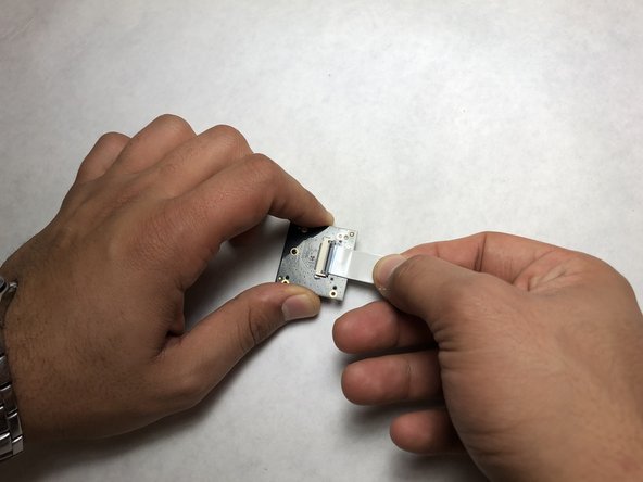

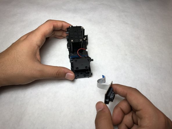

    • Pull out lens.
    • Remove cord from lens.
