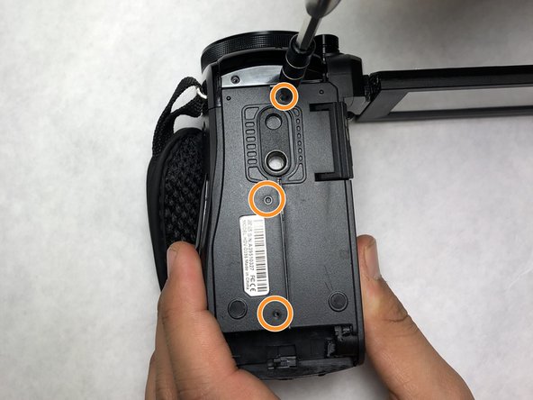

    • Unscrew the four screws on the side (length 2.9 mm) with a JIS #000 screwdriver.
    • Unscrew the three screws on the bottom (length 7.7 mm) with a JIS #000 screwdriver.

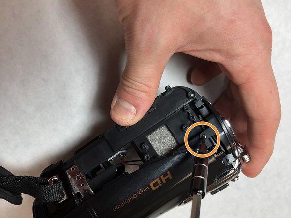

    • Unscrew the two screws (size 4.75 mm) with a PH #00 screwdriver.
    • Unscrew the screw (size 7.65 mm) with a PH #00 screwdriver.
