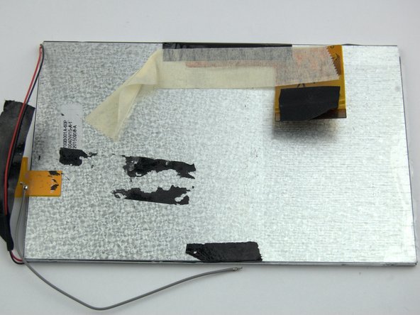

      • Unsolder the display wires from the connection on the motherboard.
      • Display wires
      • Be careful to not make contact to other components on the motherboard while using the solder iron.

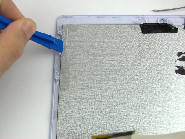

      • Along the edge of the display, there are 7 plastic clips that connect the screen to the front of the case.
      • Plastic clips
      • Use a plastic spudger to separate the clips from the display.
      • Use caution in prying the display from device to not damage the clip or the cover of the display.
