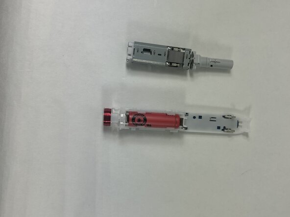

  4. Oral-B iO Series 6 Motor Replacement: crwdns2935265:04crwdnd2935265:01crwdnd2935265:03crwdne2935265:0 Oral-B iO Series 6 Motor Replacement: crwdns2935265:04crwdnd2935265:02crwdnd2935265:03crwdne2935265:0 Oral-B iO Series 6 Motor Replacement: crwdns2935265:04crwdnd2935265:03crwdnd2935265:03crwdne2935265:0
    • Carefully push the internal mechanisms out through the opening left by the removed bottom cap.

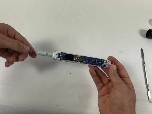

  5. Oral-B iO Series 6 Motor Replacement, Motor: crwdns2935265:05crwdnd2935265:01crwdnd2935265:03crwdne2935265:0 Oral-B iO Series 6 Motor Replacement, Motor: crwdns2935265:05crwdnd2935265:02crwdnd2935265:03crwdne2935265:0 Oral-B iO Series 6 Motor Replacement, Motor: crwdns2935265:05crwdnd2935265:03crwdnd2935265:03crwdne2935265:0
    • Flip the internal components to access the other side.
    • Apply gentle pressure to the clear plastic component and pull upward from the area where the head was previously attached.

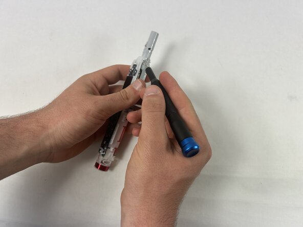

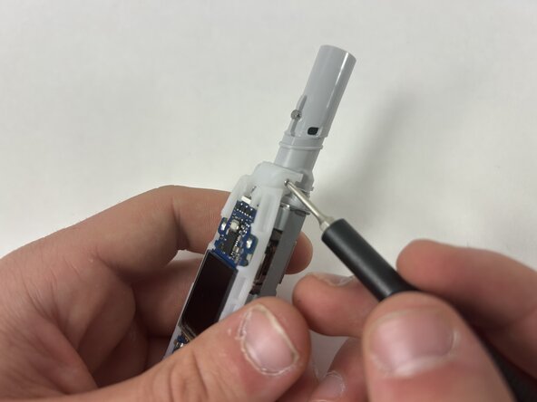

  6. Oral-B iO Series 6 Motor Replacement: crwdns2935265:06crwdnd2935265:01crwdnd2935265:03crwdne2935265:0 Oral-B iO Series 6 Motor Replacement: crwdns2935265:06crwdnd2935265:02crwdnd2935265:03crwdne2935265:0 Oral-B iO Series 6 Motor Replacement: crwdns2935265:06crwdnd2935265:03crwdnd2935265:03crwdne2935265:0
    • Using a slender tool, gently push the pin through.

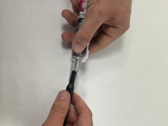

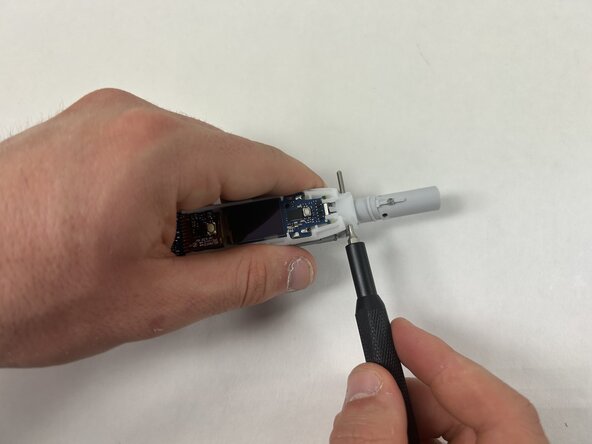

  7. Oral-B iO Series 6 Motor Replacement: crwdns2935265:07crwdnd2935265:01crwdnd2935265:03crwdne2935265:0 Oral-B iO Series 6 Motor Replacement: crwdns2935265:07crwdnd2935265:02crwdnd2935265:03crwdne2935265:0 Oral-B iO Series 6 Motor Replacement: crwdns2935265:07crwdnd2935265:03crwdnd2935265:03crwdne2935265:0
    • Remove the two screws positioned on either side of the plastic casing.

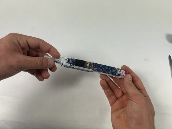

  8. Oral-B iO Series 6 Motor Replacement: crwdns2935265:08crwdnd2935265:01crwdnd2935265:02crwdne2935265:0 Oral-B iO Series 6 Motor Replacement: crwdns2935265:08crwdnd2935265:02crwdnd2935265:02crwdne2935265:0
    • Carefully unclip the motor from the battery compartment to detach it.
